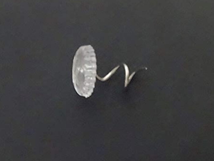

I have a few “twist pins” holding up a small spot of my headliner. traditional pushpin/thumbtacks have a tendency to fall out of the headliner. The twist pins have a spiral/pig tail pin that screws into the headliner and really anchors them in securely. Just haven’t had the time or motivation to drop the headliner and re-glue it.
That's probably what they were in my buddies Challenger, not plain tacks.
