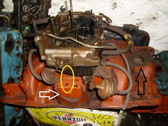

The intake is cast iron – and is not fun for us old timers to install (or even remove) when bent over a fender.
The intake shown is not a ’74 model. It is a ‘78 to ’84 piece because of the smaller and angled bolt holed thermostat housing (black arrow, above). If will fit on any FMJ-body small block engine (which I will discuss more on that, later) without A/C or with the Aluminum C171 A/C compressor. It will not fit on cars using the cast iron RV2 A/C compressor.
About ½ of all Thermoquad carburetors are good ones (mostly the early ones). The other ½, the later ones (which includes all used on FMJ cars), are not as user friendly. What I would want to know before buying any Thermoquad is what the Model number is. It will be on the Left side rear corner on base plate and will look something like this:

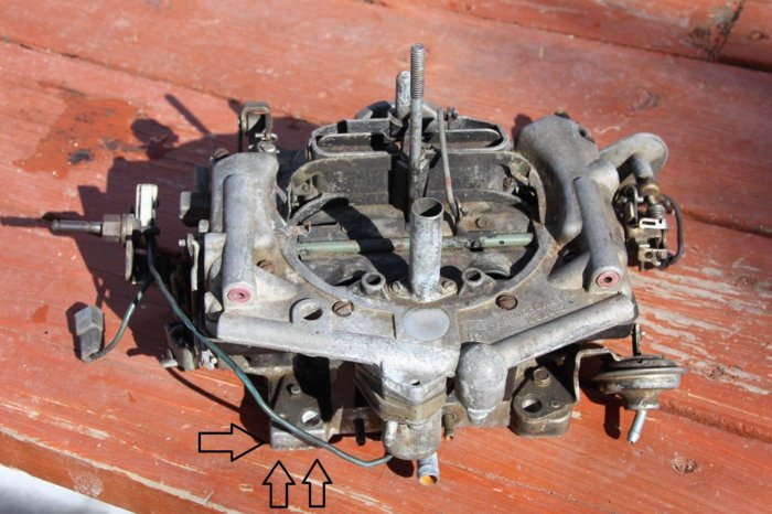

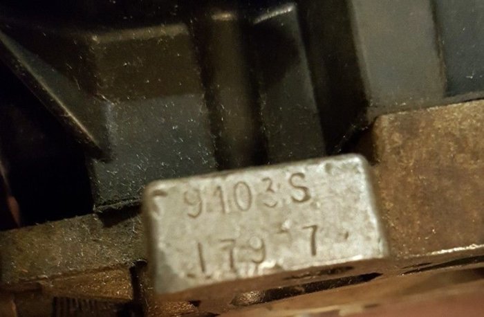

The top line will look something like 9123s (which is the only important number on the carburetor – which is the Model number). The bottom line will look like 123 4 (which is 123rd day of ‘74 (or ’84).
In the case of the above photo it says 9103s (second line) 179 7. Based with this information, the Model number is 9103s, which came off of a 1977 B or C-body 400 ci automatic car (non-High Performance). It is a 49-state calibration (not California). This one also has an Idle Enrichment attachment and has a High Altitude compensator. It also has large primary bores (which most big blocks came with, anyway).
The date code tells me carburetor was made on the 179th day of 1977. This particular carburetor (the one in MY photos) rates in the middle of choices (not the best but not the worse choice).

When looking at a used carburetor, always make sure all shafts and linkages operate freely. In this case you have the primary shaft (attached to throttle stud), the secondary shaft (may have to finger a couple of linkages to get that shaft to fully operate), the choke shaft, the air valve shaft (big trap door on top back, and so forth. If anything is not free or will not operate – just walk away and don’t look back.
The choke mechanism shaft is missing from this picture (yellow circle on top photo) – so you will need to get a Thermoquad choke mechanism (white arrow, top photo) to get correct missing part (which is not a bad idea, anyway).
