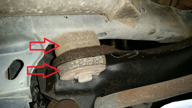

Shock bushings wear out, just like shocks wear out (look at upper right corner of fifth picture down). I have friends who will replace the (new) rubber shock bushings with urethane. Personally, I don’t know that it makes a hill of beans worth of difference on shock bushings, sense shocks are there to dampen bumps and to keep car from bouncing after a bump. Most new shocks come with rather hard bushings to begin with. My opinion is to use what comes with your new shocks and you should be fine.

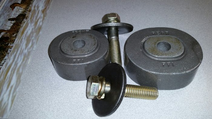

Now what will make an even bigger difference is with replacing the rubber K-frame mounts with Cast Iron (Mopar Performance), with aluminum (FFI, for example) or with urethane. I think a metal would work better than urethane – but any of the above will make a huge difference over the rubber (even new rubber, if you could find any.

FFI versions. Nice, but pricy.

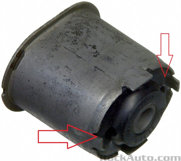

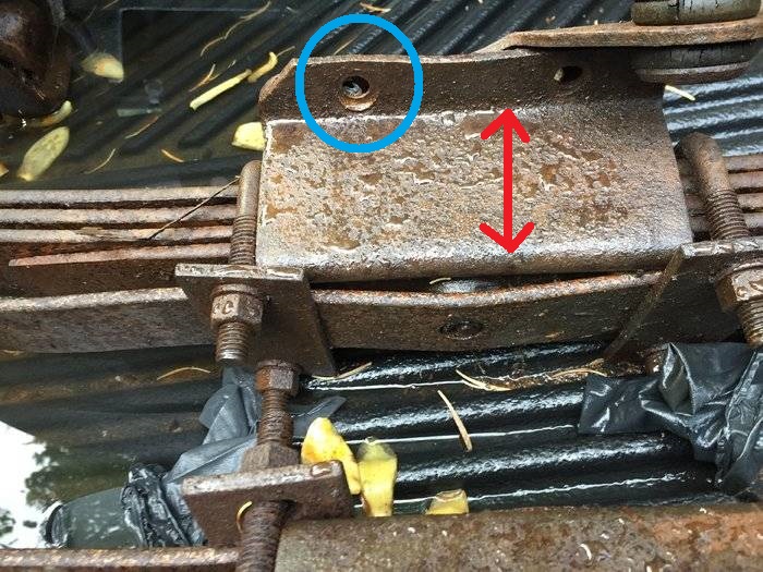

I’m not aware of anyone making urethane rear suspension front oval-shaped bushings. The oval bushings are an issue in of itself. The same oval bushing was used for ’83-07 minivans – so a supply of bushings will not be a problem for the foreseeable future.
If rear leaf spring is removed for any reason, for my own cars (or friends), i recommend inserting two bolts/studs/rods (ie: something solid) marked by red arrows - into the two holes, and re-install (per side). That will firm those bushings up, a lot.

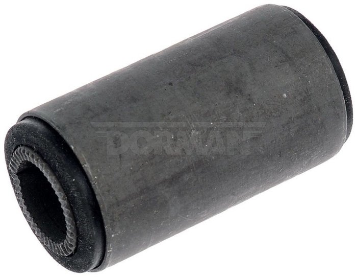

If you are going to have new leaf springs made, I recommend using the round (rubber) front bushings (‘60’s B-body) and you should be good.

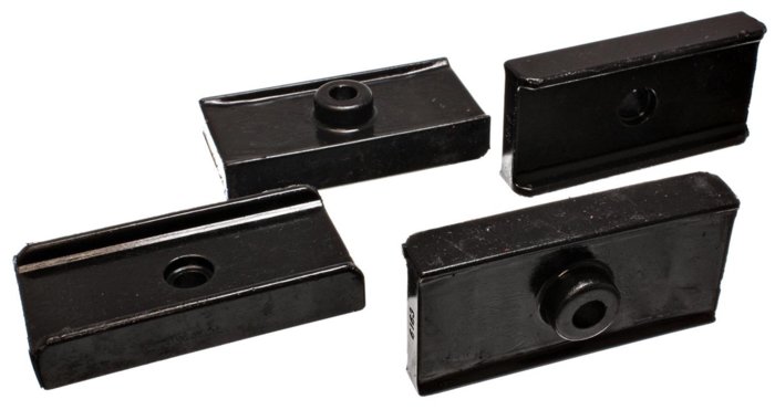

Now many members have replaced the rubber biscuits with urethane ones and have had good luck with them, but you still have the troublesome “U” bracket to worry about.
I firmly believe that even on an /6 car (like Ole Yellow, for example), removing the ISO-clamp with older shock plate, ISO eliminator or using urethane biscuits, will help the ride . . . a lot.

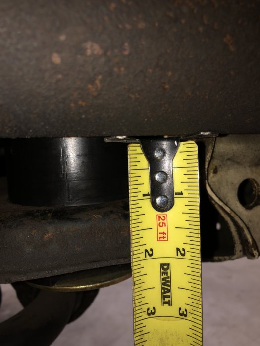

Does anyone have the thickness for the solid top bushing not including the top pad for the Kframe mounts?
Not sure how accurate you need it. The bumper shock is in the way when I took the pic but the upper part of the poly bushing is a little over 1 1/2 inches thick. I had a 1 1/2 inch piece of metal which fit between the k frame and the frame rail with a little wiggle room
