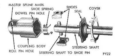

Hi folks
Now that my 79 Lebaron is running again I would like to do something about the sloppy steering.
There are about 2-3"" of play in the steering and it really takes much of the fun out of driving it.
I have seen the Borgeson ads here, but with the shipping to Denmark and taxes it will cost a fortune to go that way.
So I was thinking if a steering box from a 90´s Jeep Cherokee would fit ? It´s a type of car we have plenty of here; both with the IL6 and the 5,2/5,9L V8.
I wonder if the starter also could swapped over ? (My Lebaron is a 5,2 V8.)
