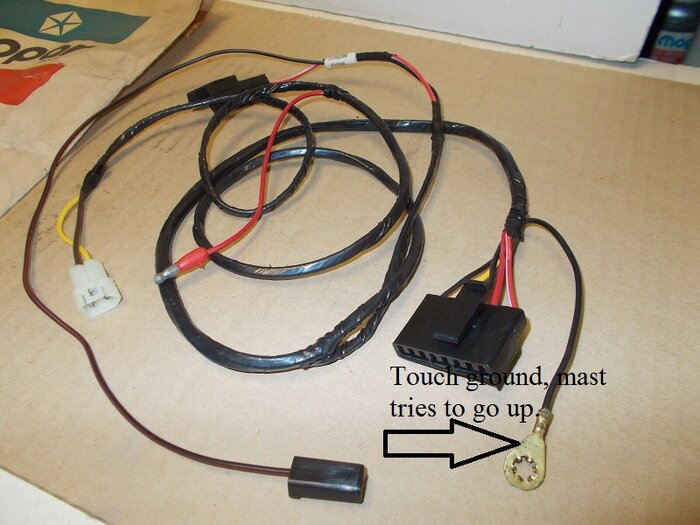

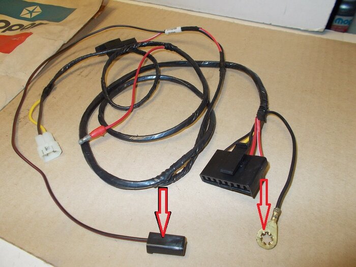

I just put a radio in. My power antenna was doing like yours, then kaput after turning on the radio a few times. I have a temporary one in until I get a replacement (aftermarket).
But the following info should help: (note EIA is "Electronics Industry Association" standard) which all aftermarket radios should follow.
