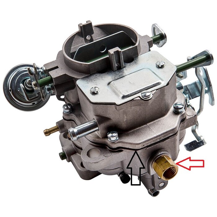

Was the original carburetor leaking fuel externally or internally (into the engine)?
If externally, where about was it leaking from?
Anytime a carburetor is replaced, rebuilt or repaired, one always needs to adjust the idle mixture, idle speeds and so on.

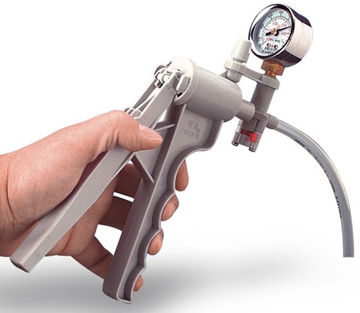

A hand held vacuum pump can check for leaks at the distributor vacuum advance or carburetor choke pull off. If you don't have one, sometimes one can be rented from your local parts store.
