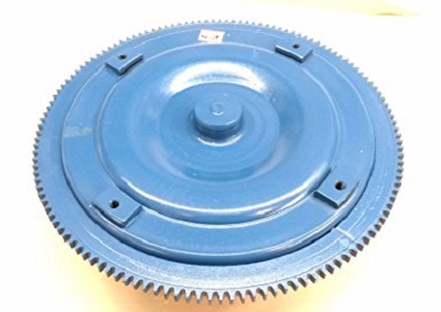

The easiest way to tell a A727 high vs. low stall converter is to look at the ring gear. If the starter ring is about ½” (13 mm) wide, it will be a high stall converter.
If ring gear is about 1” wide (25 mm) then you have a low stall (or a A904) converter

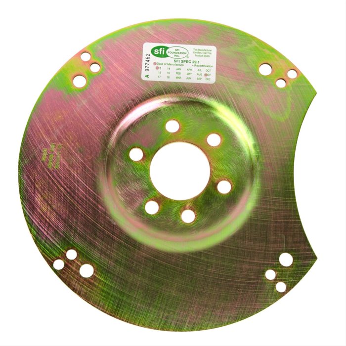

This is a balanced 360 flexplate that B&M makes (so a person can use a neutral balance converter). The outer bolt holes are A727 low stall converter. The inner holes are for A727 high stall and A904. The large holes are for Hemi's (which uses larger diameter bolts).

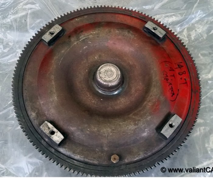

- Balance weights are one. 318’s and older engines (~72 and older) were the only ones that were not effected by balance weights. All other engines are affected.

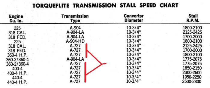

Getting back to what I was discussing, according to the chart I copied from my ’77 FSM, there were no low stall converters used in ’77. They were all high stall converters.
The area marked in red are all A727 converters. These converters are all exactly the same – except for external balance weights that were added to them. If you happen to have a ’77 440 HP converter (factory stall rating of 2500-2800 RPM), you can use a chisel and remove the weights, and now you have a ’77 318 2-bbl A727 converter with a factory stall rating of 2125-2450 RPM).
In this case, what makes the difference on torque converter stall speed . . . is the engine (only). The A904 converters used (/6 to 360-4 – not marked in red) are also the same internally – but the 360 version is different because of the balance weight.
Removing weights is not a problem. Adding weights can be a big issue.
I recommend always using a neutral balance converter and if engine needs balance weights, to get an aftermarket flexplate (like example, above).
