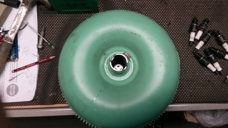

Hi Guys,
Summer down under and been busy, my engine and trans arrived. The engine is a 360 and the trans is a 904, my questions is the torque converter balanced for a 360? and if so is that an after market converter?
The guy I bought it off said it has a bit of a stall to it, it came with his car when he bought it, he removed the 360 and trans to repower with a 440, I am going to put the 360 into my Cordoba.
Also can the converter only bolt to the flex plate one way?
Thanks
Bruce

Looking at your picture, the converter is balanced because of the two weights on each side of the drain plug. Also a converter will only bolt up one way. you need to line it up with your flex plate before you install the motor and trans and mark it correctly.

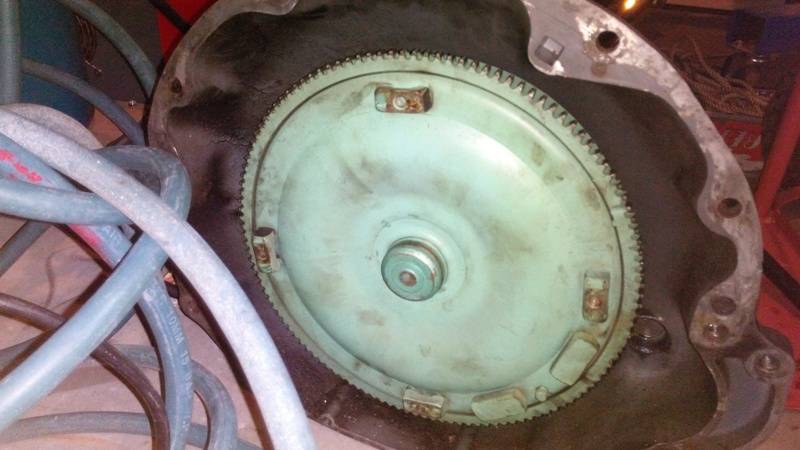

So get the convertor and work out where the bolt holes line up, mark the converter and flex plate, slip the converter into the trans, lift the trans to the engine then put a couple bolts in the bell housing, then line up my marks and bolt the converter up to the flex plate?

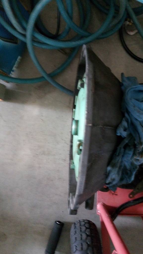

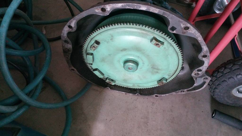

ok its not in right, youtube is great just watched a clip on how you install a converter
I have it in right now, I felt it clunk in :)

Looks too far out. As you put the converter in, rotate it a little and you can feel it drop in, then rotate a little more and engage the pump. When it is in properly and the bellhousing is bolted to the motor, the converter has to be slightly pulled forward to bolt to the flex plate. I posted before I saw the youtube post.

Looks like an aftermarket 360 balanced convertor. The weights are for the 360s offset external balance. When the converter is all the way in it sets pretty deep, it moves back out when you bolt it to the flex plate. There is a small "o" stamped on the comvertor that corresponds to a small hole in a stock flex plate. It is easier to line up the plate and mark them
