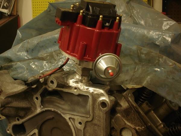

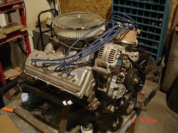

Greg55_99
Apr 17, 2011
331
78
Some years ago I came across a guy in Canada that would sell you a modified Hemi front cover from a truck modified to take an HEI distributor. When used with an aftermarket 4 bbl intake, it simplified Hemi installation a LOT. Of course, there was much debate on how less efficient this was compared to electronic fuel injection and so forth. Personally, if I was going to do a Hemi swap, that's how I'd do it. Dumb the engine down. But hey, hotrodders will always find a way....
