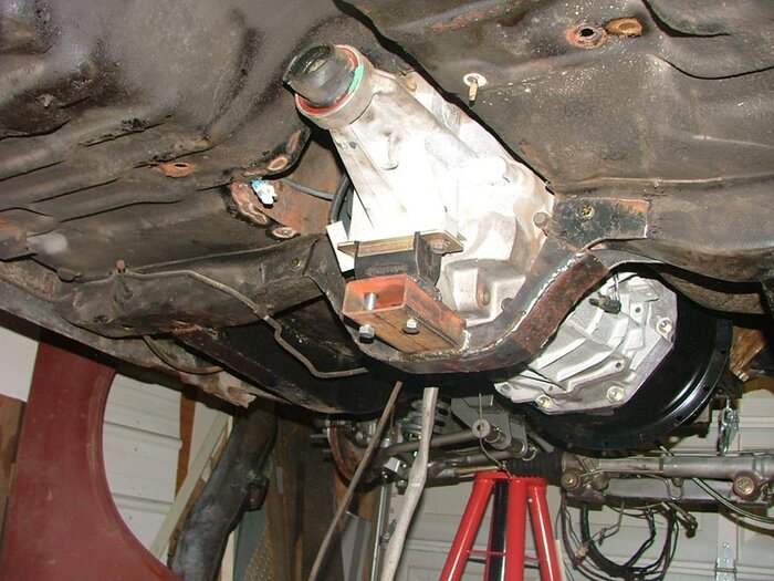

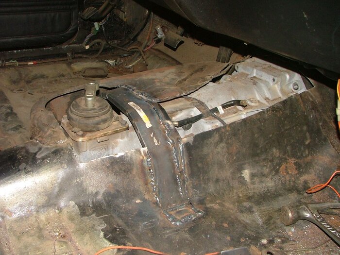

That's a T56 pic in an A Body but the amount of floor cutting is the same.
