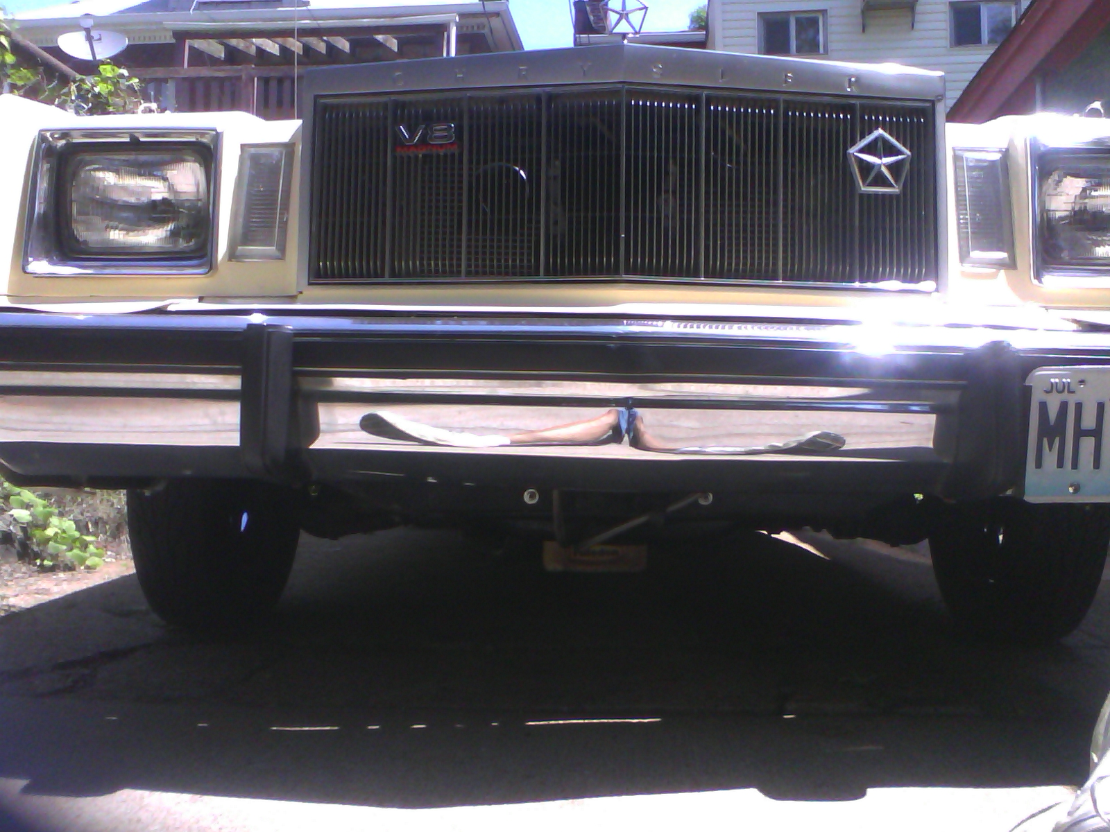

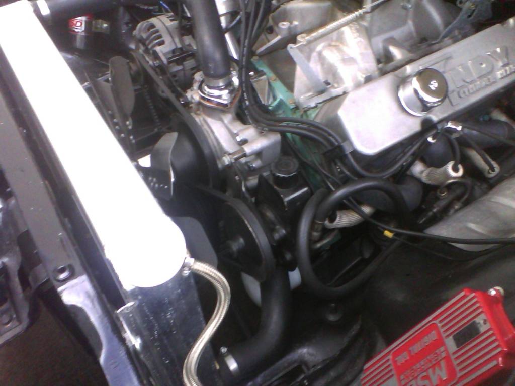

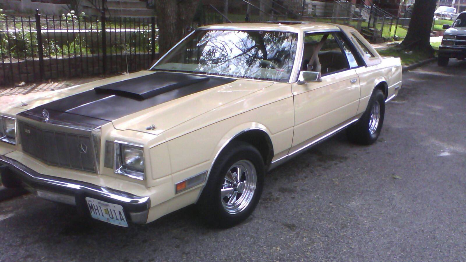

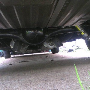

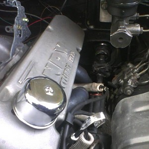

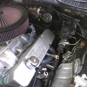

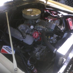

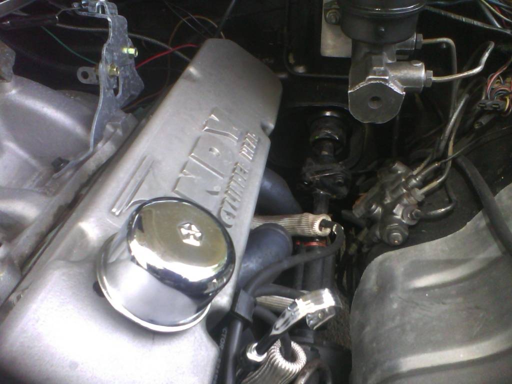

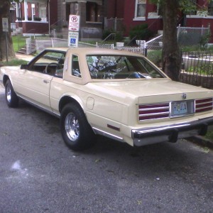

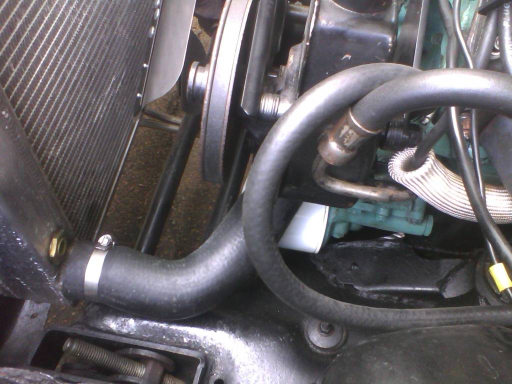

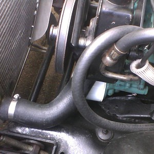

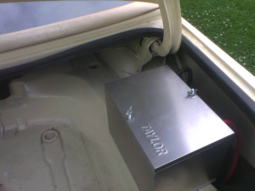

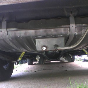

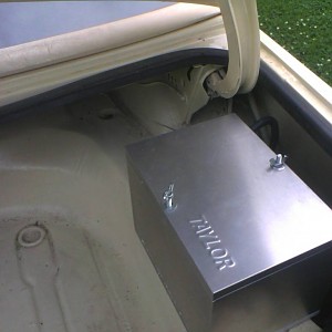

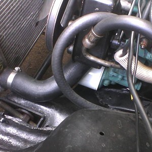

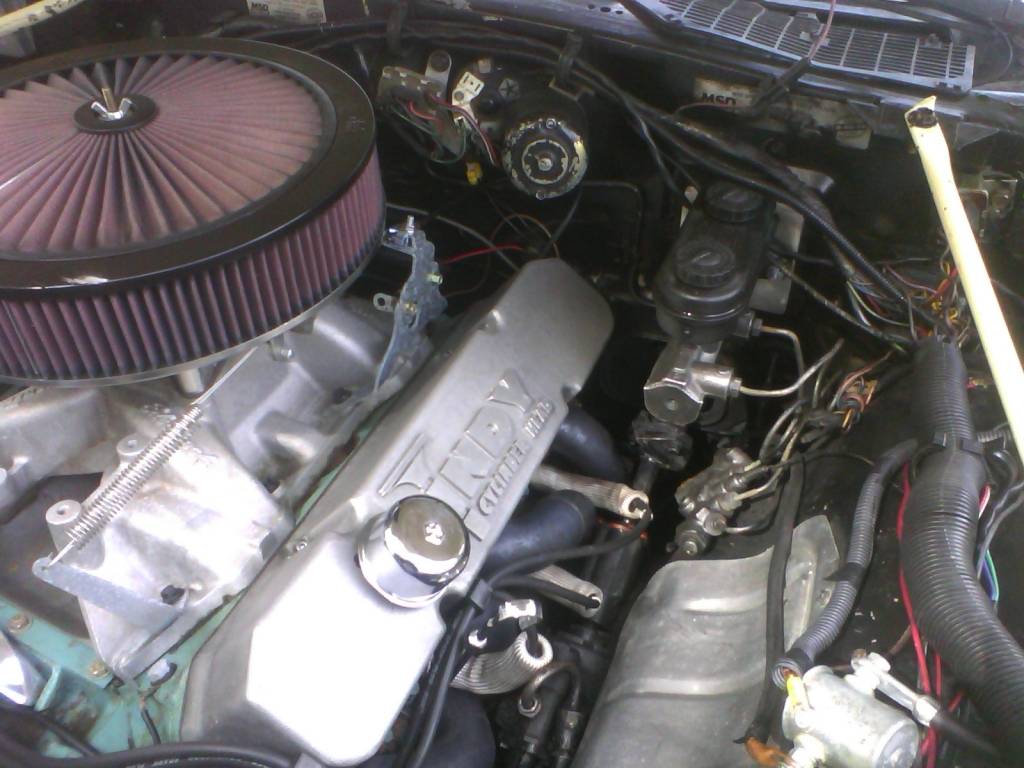

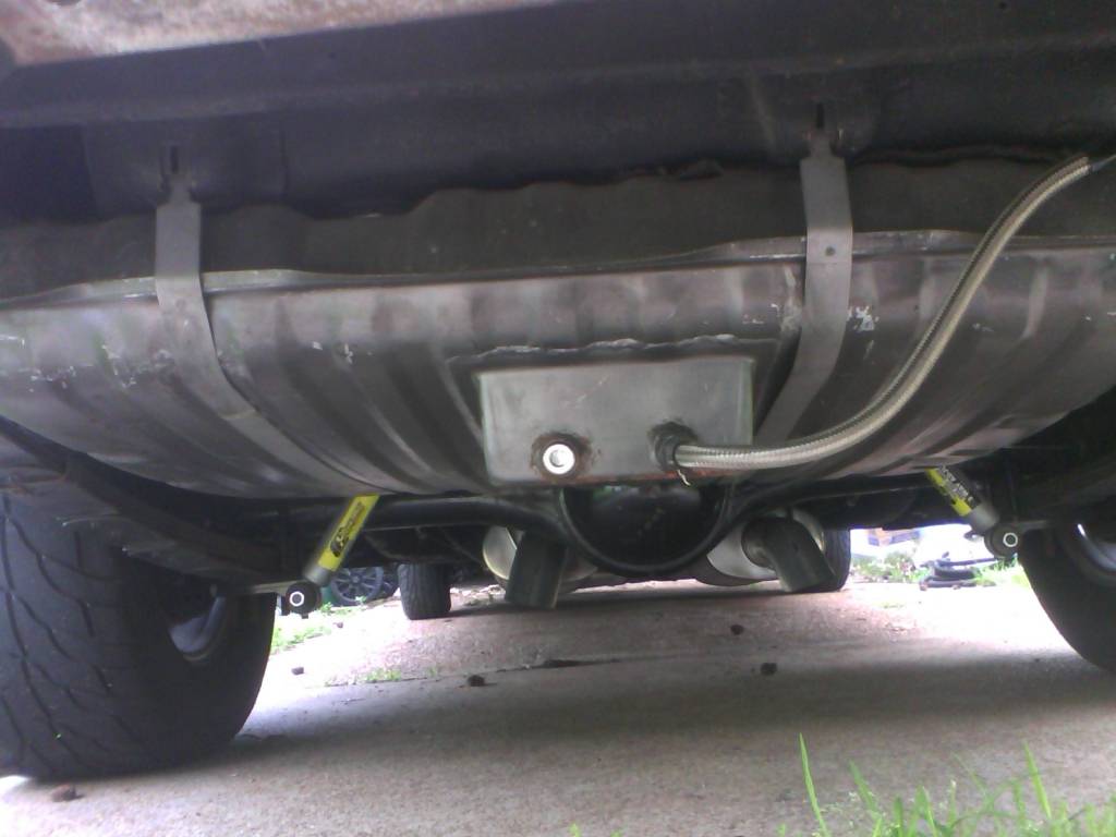

Original 318 engine swapped out to 400 bored & stoked to 502 cu. In. Lunati Voodoo cam , 452 ported iron heads, 870cfm Holley street avenger carb. 7gt oil pan 2" headman headers into 3" x pipe to 3" magna flow stainless mufflers. 727 tranny with cheeta manual valve body, 3500 stall converter, 8 3/4 rearend with 4:11 gears. Super stock springs & pinion snubber, competition engineering adjustable rear shocks. Msd 6al digital box, distributor, & coil. Battery relocated to the trunk.
