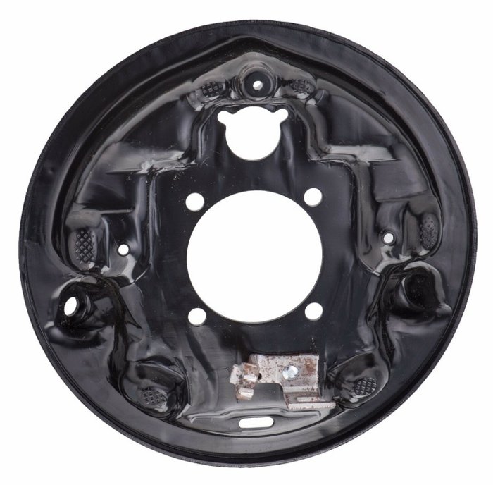

    The rear brake backing plates that use the external axle shafts (some Dana 60’s, and all Dana 70/80’s)) then backing plate will be different. I refer to this design (full floating axles) to be an external axle shaft (the brake drum or inspection cover do not need to be removed before axle removal).

    This backing plate is for a Dana 70/80 and Dana 60 with external axles. Notice how the 4 bolt holes are symmetrical. This will not work on FMJ's.

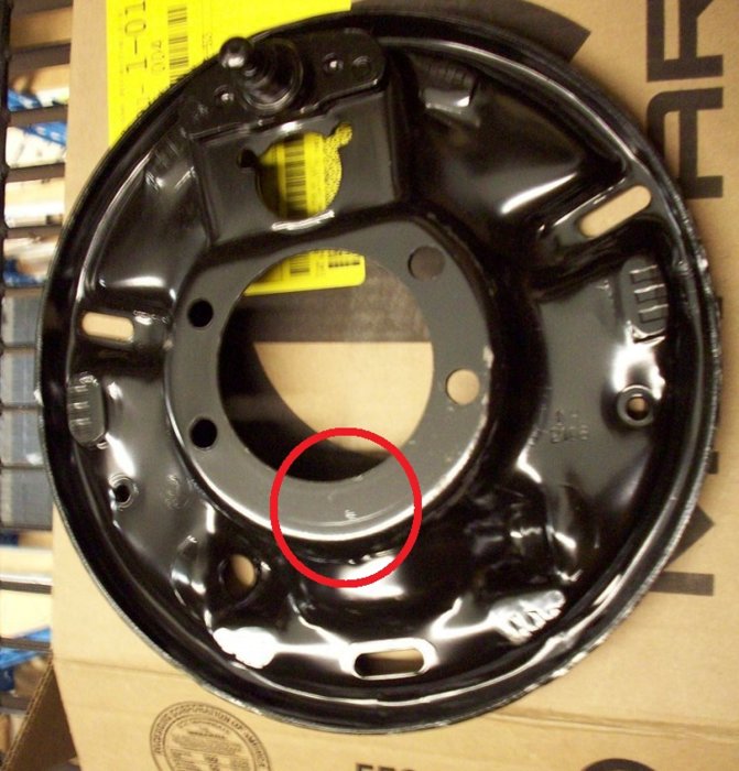

    Some of the newer jeeps/pickups, have moved from a 5-bolt pattern to attach the backing plate to the differential to a 4-bolt system. They will still work if you drill out the fifth hole.
    The red circle is where the 5th hole needs to be drilled. This is from a newer Jeep.

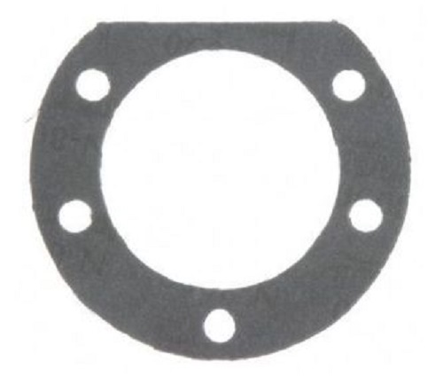

    This is the bolt pattern used for all Chrysler cars from '60-89 (and longer for pickups, vans and Jeeps).
    To recap, all Chrysler cars, made from ’60 to ’89 (and many newer pickups, vans and jeeps), rear brake backing plates will interchange on all cars, even if on a 7¼”, 8¼”, 8¾”, 9¼” and 9¾” (car Dana 60). That includes 9” (older A-body’s), 10” and 11” drums (or in case of some pickups 12” drums). The only issue is some of the post 2000 vehicles, which might need to have a 5th mounting hole added.
