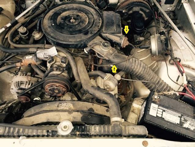

Went shopping came out the cranked but didn't fire. Checked was getting gas, noticed vacuum transducer hose wasn't plugged to anything. lifted the air cleaner didn't see at the time where to hook to carb. put a screw in hose fired right up realized after the screw didn't do anything no vacuum source. figured later just moving the air cleaner around jarred the spark control computer. later i found the port on carb passenger side had a hose with screw in it. when bought car from cti knew they had emissions not safety the hose that plugs in under air cleaner wasn't hooked up as well. plugged all the lines back to where they went fires up no problem but still issue with stalled on turn when cold. spark control computer was replaced in 98 with mopar ordered new from cardone remanufactured question what tools do i need to replace and how is it mounted to air cleaner. the funny thing is before this happened the car ran fine no stalling ran normal even the way the vacuum hoses being the way they were. I realize converting is the way but I like to keep it the way is was thanks any help appreciated Kevin
