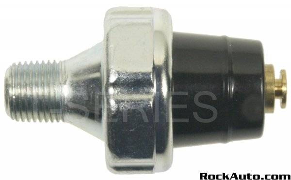

Oil pressure switch (for idiot light) (by far the most common).

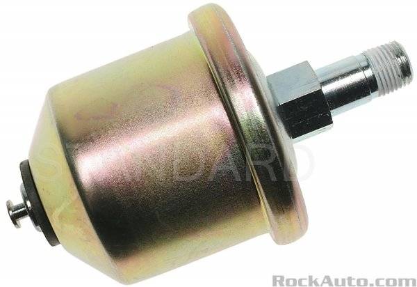

And Oil pressure sender (for oil gauge).

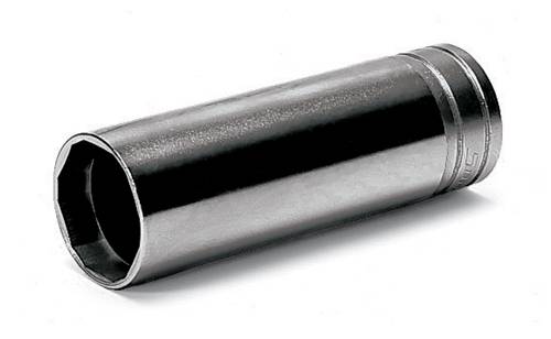

The switch (smaller part) does require a special socket to remove – but in some cases, you can use a normal deep socket (depending on how your socket wrenches are made).
The sender (larger all metal part) uses an end wrench to remove/install. I “think” it is 7/16” size. Generally the only cars I see with the oil pressure gauge are special order, police and taxis.
A huge majority of M-bodies came with idiot light (smaller switch).

Then just push the wires aside, disconnect the electrical connector, put the sorta special socket over it )(straight down) and unscrew like a (weird) bolt.
