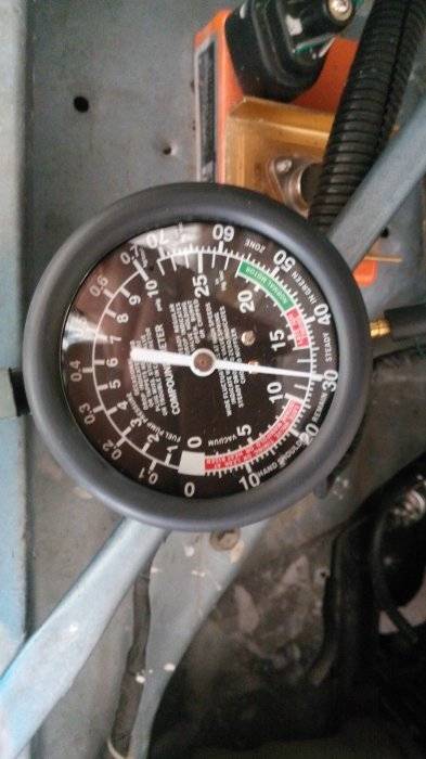

I got the vacuum gauge out last night and took some measurements, see attached photos.
So that's 12 inches at idle at 850rpm. give or take the accuracy of the needle thickness, but would be pretty close to 850rpm.
Now what does this suggest, will let the brains see what they think, but to me its got a reasonable cam in it, something like 1800 - 5800 or 2000 - 6000 or their abouts its got quite a rough idle but not what I would call lopey. Gets some revs on and it smooths out nice.
