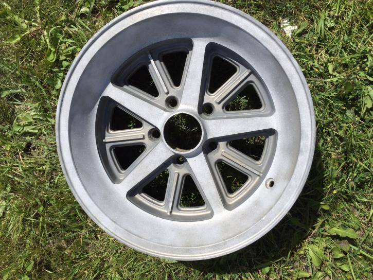

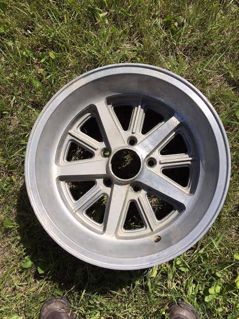

I had promised this a long, long time ago, but finally got to it. I have just abrasive blasted one of my 5 on 5 wheels, and I have some pictures.

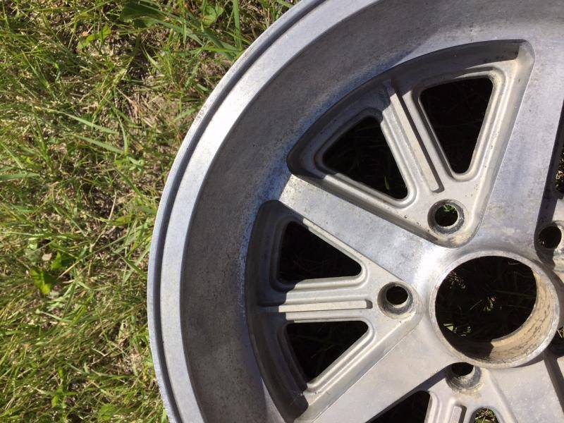

This came out of a few missteps, and some research. My first stab at this was to try to remove the factory wheel paint using aircraft stripper. After using up a lot of aircraft stripper, and getting pretty much nowhere, I started looking at either sanding the wheel, or abrasive blasting it. Sanding had two drawbacks: 1 Labour intensive; and 2: I didn't want to round off any sharp edges, of which there are many on a 5 on 5. Research on Eastwood's site, and going back and forth with Eastwood's technical people, pointed towards crushed soda glass blasting. However, as much as I would like to get the Eastwood spot abrasive/soda blaster kit, the cost of shipping and now, exchange, made this a pretty expensive proposition just to do an experiment. I found some cheaper equipment locally. Most likely, now that I know this works, I will be buying the Eastwood kit, soon.
The 5 on 5 looked like this before I started:
A close up of the two spokes I tried the aircraft stripper on:
It looked like this, post blasting:

A few things that became obvious to me after this experiment:
1. This works well. The paint is gone, and the aluminium surface appears undisturbed. Edges are still sharp.
2. The post blast picture appears a little bit splotchy, because it is; not because of the glass blasting, but because I wasn't careful enough. This was my first shot at this, and I need to be more consistent. I also forgot to blast the inner, thin set of spokes, and the part of the wheel flange that sits beween the thicker outer set of spokes. The particular gun I used is really quite precise, but needs to be refilled oftern (9 oz. capacity).
3. Next time, I will be more careful about closing off open areas; like the separation between my gloves and overalls. Safety equipment is a must; you don't wnat to be breathing in the crushed glass.
4. Surface is now to the point where I can start sanding with some 280 or 400 grit wet/dry sandpaper.
5. The blasting is really good at getting into some of the more awkward areas, like the curve of the lip near the center hole.
6. Not having done this before, the trigger finger gets pretty sore after about 15 minutes (this took about half an hour of actual blasting, probably an hour overall with the refilling and putting on and taking off the safety stuff.).
I used about 3 1/2 9 oz. refills of the gun to do what I did. If I had done the thin spokes and flange areas that I talked about, it would probably hve taken another 1-1 1/2 refills.Figure on 5 9 oz. loads to crushed glass, 45 oz. or so. 45 oz. is just under 3 lbs. A bag of 60/30 crushed glass ia $12.99 for a 50 lb. bag. I could theoretically clean off 16 wheels.
