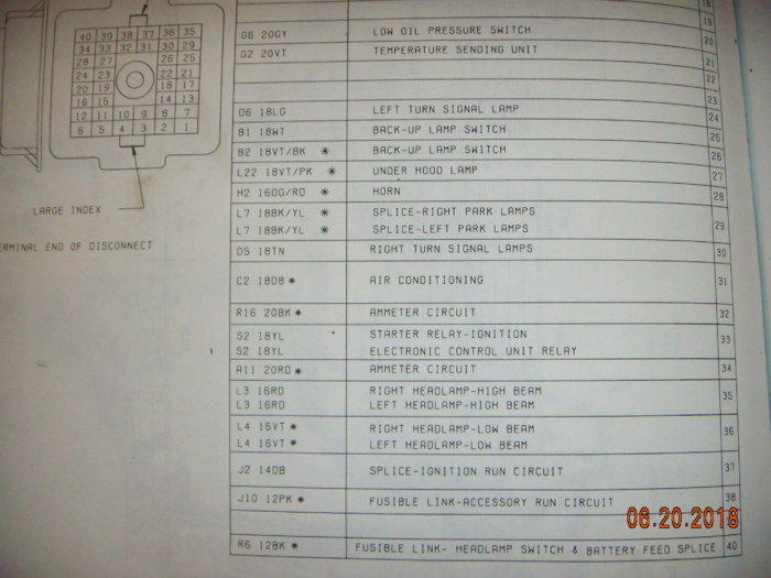

    am changing from lean burn to 4 pin icm trying to find s1 and s2 to feed units thanks

    For 1983 S X car lines: Bulkhead connector #33.
    Trace
    S2 18YL STARTER RELAY-IGNITION
    S2 18YL ELCTRONIC CONTROL UNIT RELAY
    Both are listed for #33.
    May be the same for '82

    thank you very much--this is a great help--i see 33 for the icm feed and37 for run when u are color blind like me this saves me a lot of work thank you again geo.
