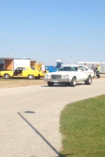

Yep B body rear 67-70 will bolt right in, you can use the shock mounts also to get rid of the rubber F body mounts. I have one in mine, just need to upgrade rear springs now.

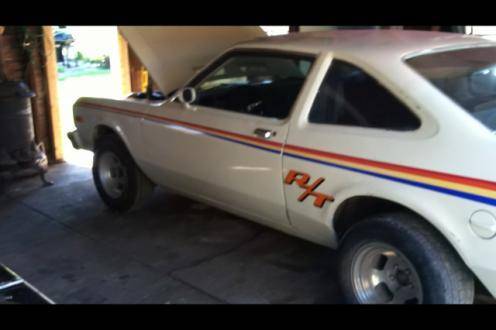

Here is some reference info for the 8 3/4
Housing widths, flange to flange
A BODY
'66-'72= 52 5/8"
B BODY
'62-'63= 53 1/4" (And '64 Max Wedge)
'64 = 55 5/8" (Exc. Max Wedge)
'65-'67= 54 1/4"
'68-'70= 54 15/16"
'71-'74= 57 7/8"
'71-'73 wagon= 59 7/16"
Spring perch widths (center-to-center)
A BODY
'66-73= 43"
B BODY
'62-'70= 44"
'71-'74= 47.3"
Rear end widths, drum-to-drum:
A BODY
'66-'72= 57 1/8"
B BODY
'62-'63= 58 1/2" (And '64 Max Wedge)
'64 = 60 7/8" (Exc.Max Wedge)
'65-'67= 59 1/2"
'68-'70= 60 1/8"
'71-'74= 63"
'71-'73 wagon= 64 3/8"

On the exploder 8.8, that is a very good alternative and in my area anyway fairly cheap too. Disk brakes and limited slip are a plus if you find one equipped with them. Bolt pattern should be the same 5x4.5
