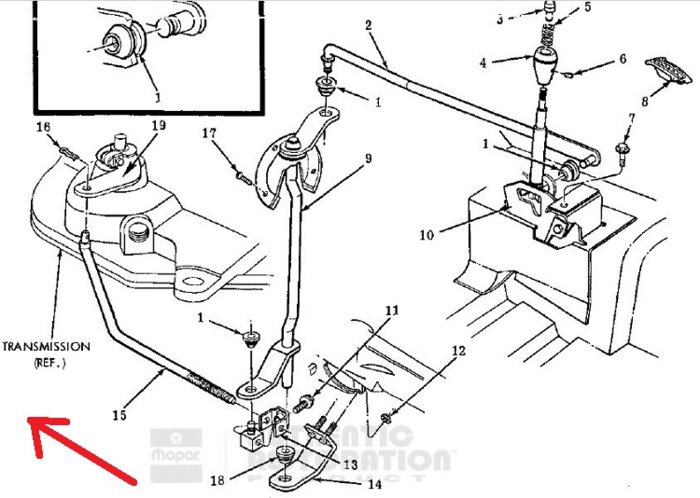

Center consoles/shifters were installed in F and J-bodies, and in a few M 2-door cars. The ’84 Gran Fury police car I had, should have the same seats you have, and that car had plenty of space for a console. Finding a good complete FMJ console might be a bit fun but I do see them for sale from time to time – but that isn’t the question at hand.
If using factory parts – the linkages from transmission to the shifter is about the same on all ’66 and newer ABCEFMJ cars except for the shifter itself (which has a few variations over the years).
From my '77 Parts Manual for F-body (above and below floorboard). Arrow is pointing front.

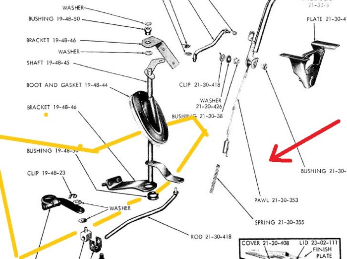

From my '73 Parts Manual for A-body. Gold is a rough outline of transmission.
The issue is the interior shifter parts looks really odd without a console to cover said parts.

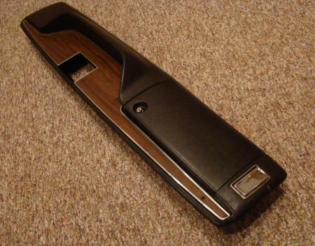

I suspect the E-body and newer/older B-body consoles will as well – but not tried. I think the E and early '70's B-body console looks much better than the FMJ version – but that is just me (which all parts for are being re-popped, for).

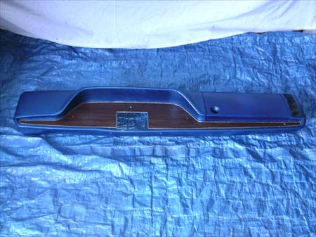

A '70-74 E-body / '71-74ish B-body console:

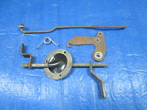

About 2/3rd of the linkage (missing the transmission bracket, link to shift arm and its lever (and shifter)) and the welded in floor brackets inside (but can be screwed on).

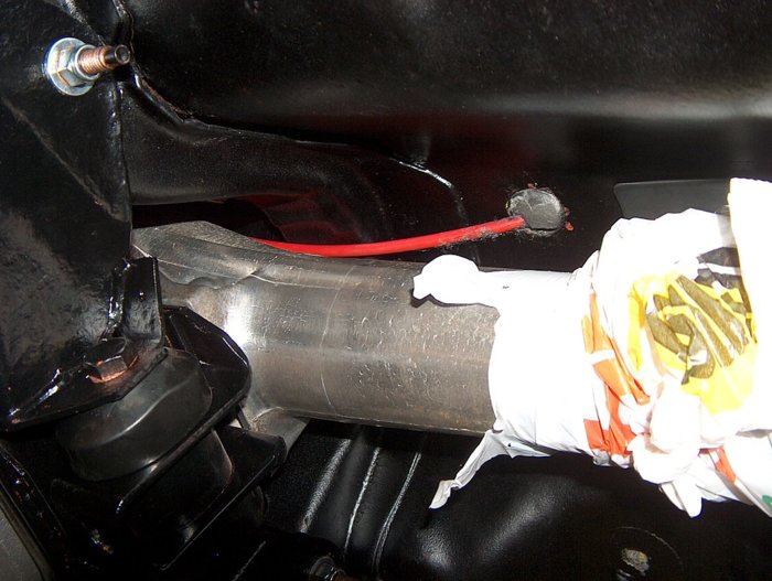

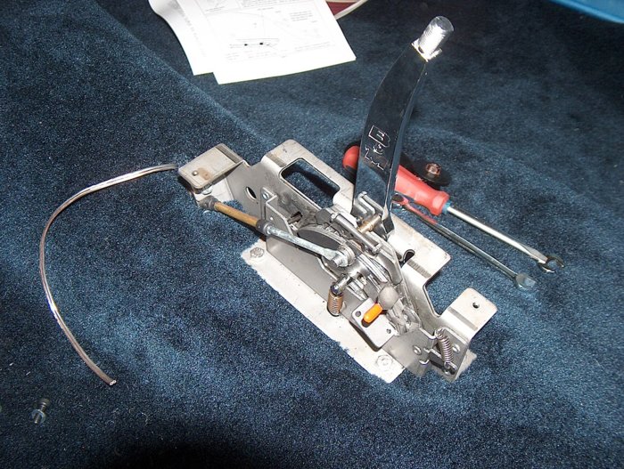

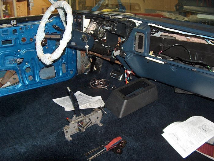

Alright...so you asked for Aftermarket, and that's what I'm going to put in front of you. The other guys did an awesome job reviewing the factory/stock options!
I went down the path of B&M QuickSilver ratchet shifter. Love it!!! Now keep in mind that's my only experience with aftermarket shifters, so there are probably plenty of other nice and better shifters, but for me this was about putting something in the car that did not look "race car" like and had as little of an impact as possible.
Keep in mind I did this while my coupe was completely stripped down, so plenty of room to do anything I wanted. Carpet was out, I did drill a slightly oversized hole in the floor, after taking the photo I did actually go back to put an one of these rubber rings over the openning to prevent the shift cable from getting cut. I am also running a line-lock, so there is the wiring going to the T-handle.
So here we go, tried to put these in somewhat of an order from START to FINISH.

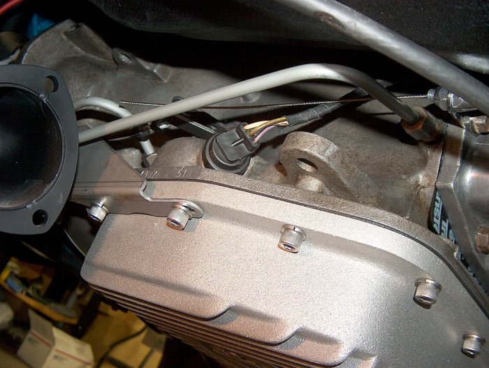

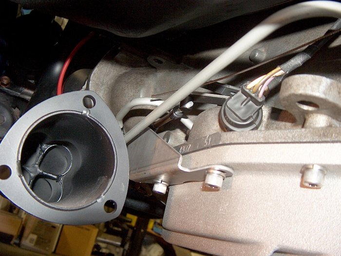

These next two show you the reverse layout of the shifting cable and the throttle kcikdown cable. The RED cable is the gear selection cable. The steel line anchored to the trans case is the kickdown cable.

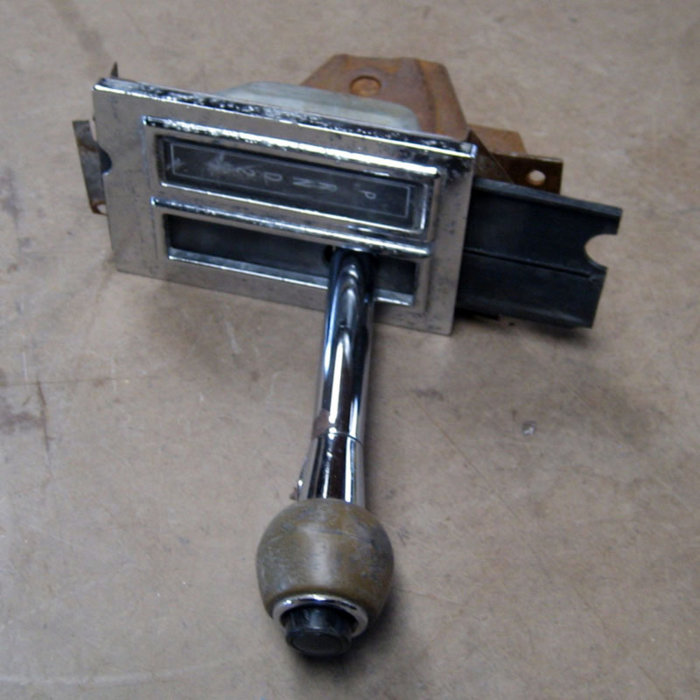

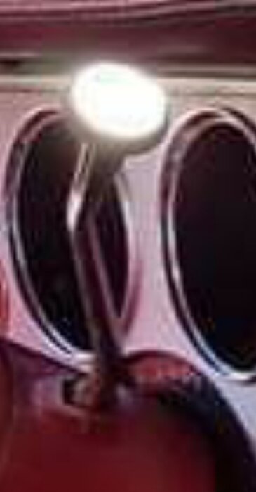

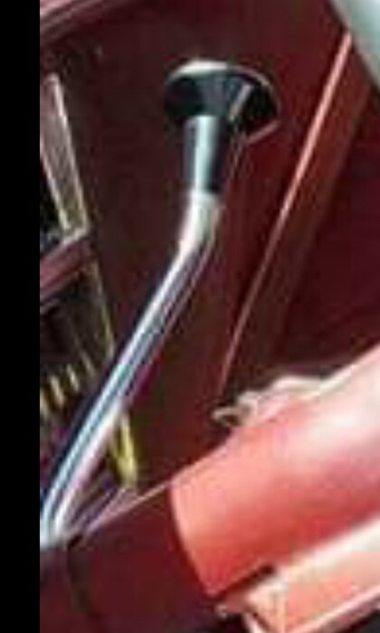

Still kinda on this a little. I guess there are two types of column shifters, so Im looking for the "other one" (see pics)
If I cannot track one down, I'll have to make the jump to the B&M as mentioned above. Ultimately, I'd prefer the floor shifter anyway, but my wallet says otherwise.
Disclaimer* sorry for the poor picture quality, its a screenshot of an old picture, cropped to show the necessary item.

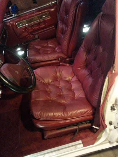

1,666

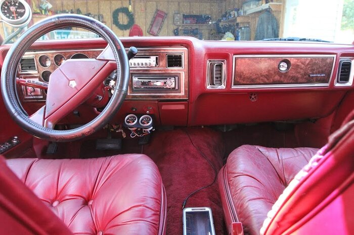

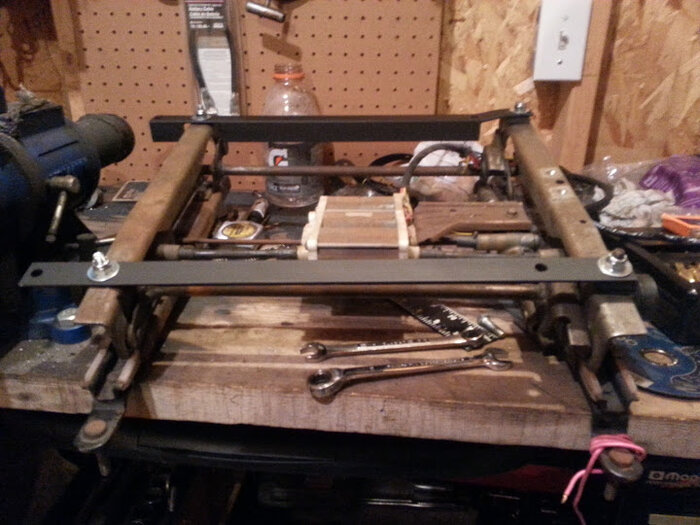

Have you swapped in bucket seats yet? If not I hope you're Stretch Armstrong.
If you can't find a set of coupe seats that match you could always mount another passenger seat to the driver's tracks. Requires making some mounting adapters out of 1/8" angle iron. Not a big job really and comes out pretty good.
Got lucky enough to find another red leather 5A at the yard with a beautiful interior. I like how it turned out on mine.

Just to update this..through the joys of networking I was able to get my hands on the "double bend" shift lever. After numerous headaches regarding the swap, its finally installed and there is plenty of room now.
Gotta track down a trans leak and give the car a bath..then it should be time to finally give it the thrashing it needs.

Know what it came out of by chance? I’ve had the thought of torching mine and bending a goose neck into it; would be nice to not have to do that, lol.
brotherGood
Mar 31, 2013
158
Urbana OH
Maybe early Ms? Possibly magnums/Cordobas, something of the sorts.
I couldn't narrow it down, so I called for help..ha
