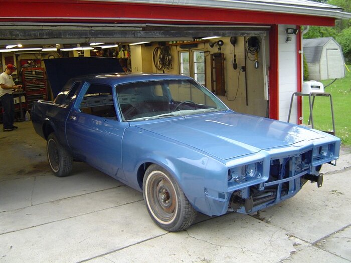

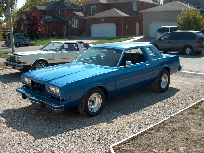

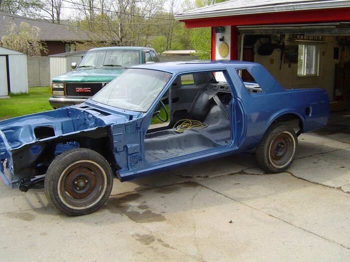

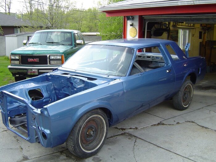

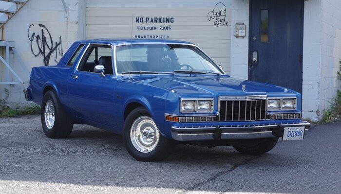

I painted mine myself. I had bought a supplied air respirator in the early '90's when I first painted it and used base/clear. The isocyanurates (sp?) in the clear are NOT filtered out by a conventional carbon respirator, and are something that could potentially kill you, or at least give you a night in the ER (don't ask me how I know that). This time (early 2010's) I also invested in HVLP spray guns to stay legal, and with the cost of paint to put more paint on the car than in the air. Rib Mt. has an ordinance that allows you to paint your own car, provided you use HVLP. If someone complained, and you weren't using HVLP, it could be a $2,500 fine. Either way, with HVLP. you save a lot on paint and overspray clean up. Anyways, even without the equipment, it was still about $1,500 for all the paint materials from primer to sealer, base, clear and all the activators, reducers, etc. I did get an estimate from an excellent body shop just a couple blocks from my house, and it was for around $10,000 to finish bodywork, do all the paint steps, sand and buff the clear, etc. plus sand paper, fillers, masking tape/paper.................It adds up. He saw how the rust repairs an initial bodywork had been done, and was comfortable putting his shops name on it, which I considered a huge compliment! I know it would have been absolutely flawless but $10K was more than I could comfortably afford. Body and paint are expensive to have done, and not cheap to do yourself, especially if you have to buy all the equipment to do it correctly and safely.. There is a sign at the body shop I mentioned that says "cheap body work is not good body work", and t's true. They've has been in business, in the same location, since 1953 and I've seen cars that were smashed half way to the windshield, and when they get done you'd never know it had ever had so much as a ding. I'm talking outside, under the hood, underneath, no matter where you look, it looks 100% factory untouched original. It's almost like magic! That's the kind of shop you want to seek out if having your car done.
Should mention $10,000 included doing the engine compartment, door jambs, inner doors, underside of the hood and deck lid, etc, plus bolting the panels back to the body, lining them up, things like that.
