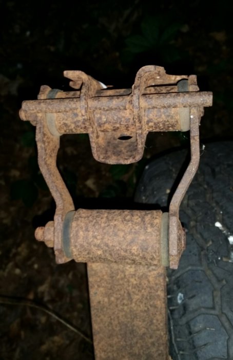

The cars with factory rear sway bars, the rear spring hanger/shackle looks like this:

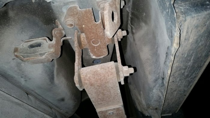

Compared to everyone else’s FMJ:
A person could special order any FMJ with rear sway bar – but the only cars I have ever seen them on, were police cars.
The shackle part (with rear sway bar) is also used in all Minivans from ’83 to 95 – so that part is not too hard to find. The rear hanger is different and it only fits FMJ vehicles.
I have measurements somewhere – but with finding the correct tubing size, a person can weld ends onto a “non-sway bar” rear hanger and it will work fine.
I did have a handful of minivan shackles – but down to a single one, now.
Note: the ’96 and up minivans are shaped the same, but rod diameter is smaller and they are metric, whereas the ’95 down minivans/police FMJ are SAE.
