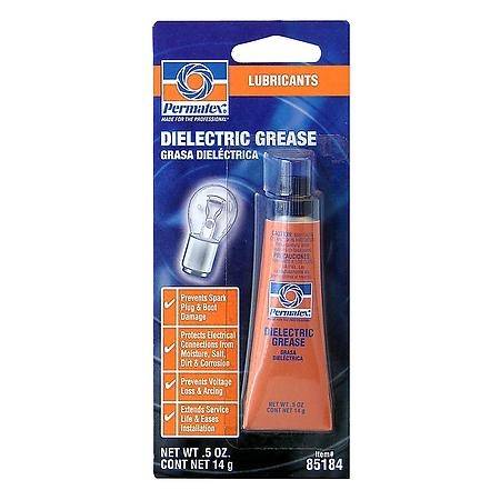

    I was just going to suggest the DeoxIT but you beat me to it!
    Another good idea is a small amount of dielectric grease on the terminals to prevent reoxidation. Don't go overboard though.
    Note I said dielectric grease, NOT grease.

    True on the plastic.
    Mind you those connector plugs are pretty hardcore. Almost like bakelite. But precautions never hurt.

    Every time I open a connector ....... a lil dab'l do ya ... like Brylcreem ... lol

    So maybe clean em off with the sandpaper and stick the dielectric grease on the end and just reconnect?
