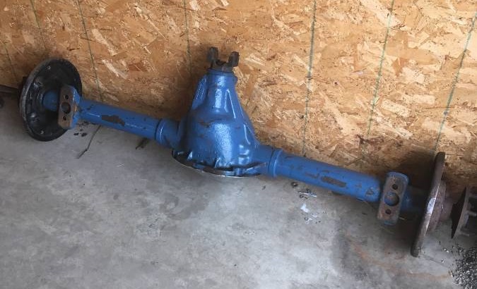

    I'm going to be selling my 8.75" housing in the Spring. 4.10 gear, SG, 489 case. Will bolt right into an F/J/M.
