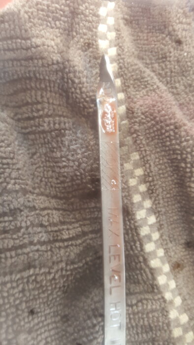

Jul 28, 2022 #1 MoparDan Well-Known Member Joined Mar 17, 2011 Messages 709 Reaction score 304 Location Daytona Beach, FL I check the trans fluid and I saw bubbles on the dipstick (see picture) this doesn't seem right, what would cause this and how serious is this?
Jul 28, 2022 #2 Aspen500 Well-Known Member Joined Feb 14, 2015 Messages 7,029 Reaction score 2,758 Location Rib Mountain, WI Over filled or under filled will cause foam/bubbles. Also if a pump or valve body seal/gasket leaks, the pump can suck air into the system.
Jul 28, 2022 #3 MoparDan Well-Known Member Joined Mar 17, 2011 Messages 709 Reaction score 304 Location Daytona Beach, FL I'll check the fluild level again shortly, but I believe it was where it should be. At one point it had a very slow leak (I'm not sure where) and I'd have to add fluid, but then it stopped leaking somehow, I know that makes no sense but its true
Jul 28, 2022 #4 Aspen500 Well-Known Member Joined Feb 14, 2015 Messages 7,029 Reaction score 2,758 Location Rib Mountain, WI Just to be sure, are you checking the fluid level in neutral and not park?
