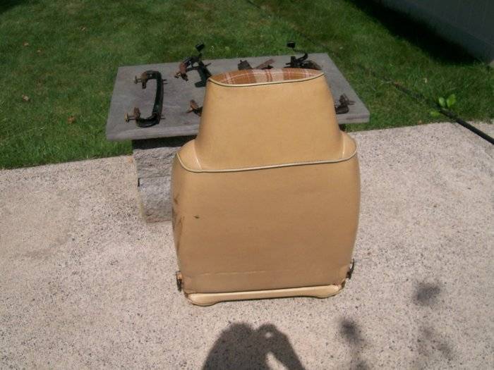

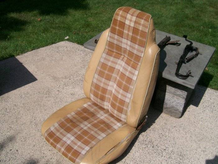

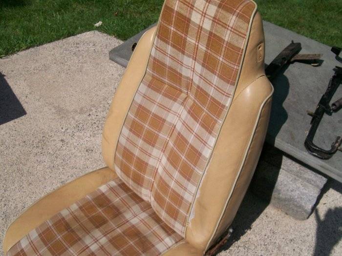

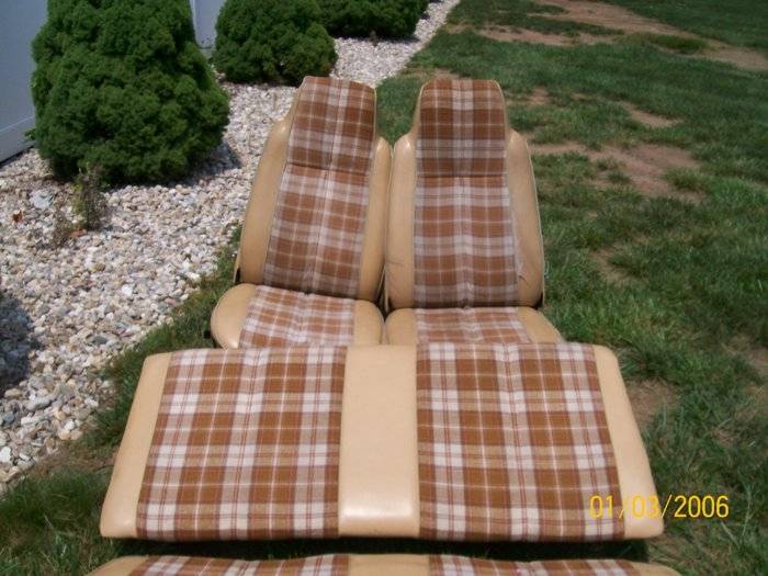

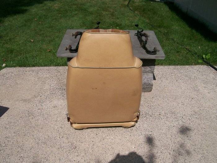

    Nice Bucket seats and tracks and rear seat correct for 79-80 will fit all years.$250.00 or BO

    The seats are out of a 2-door, 4-door or a station wagon?

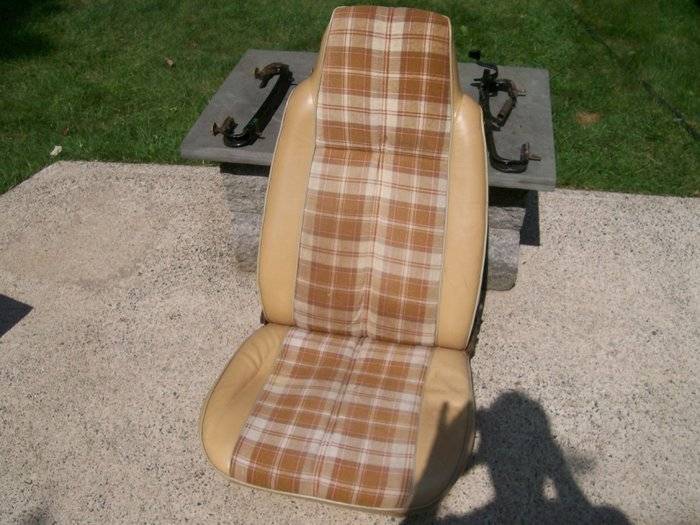

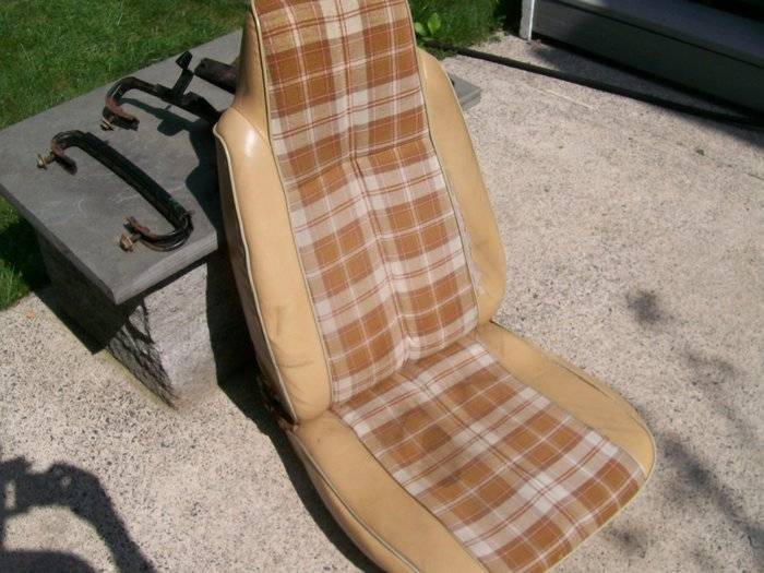

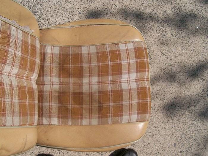

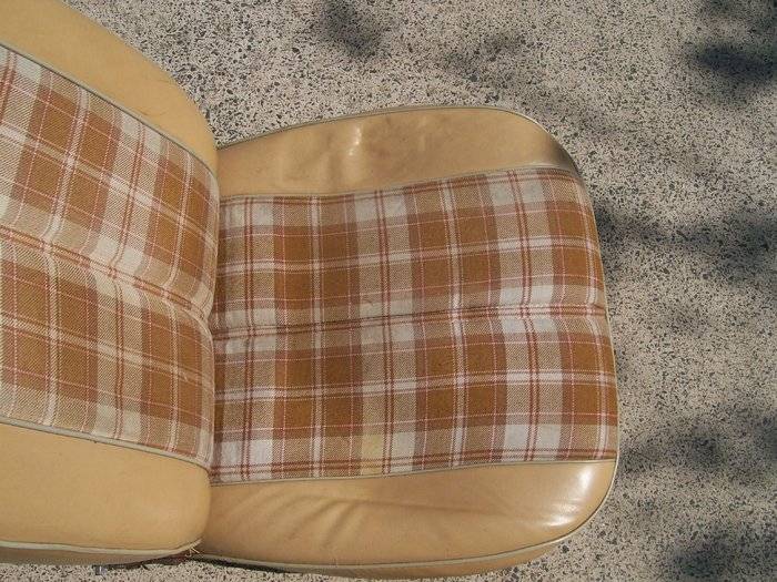

    I also have a set of black buckets out of a 77 coupe

    That plaid just makes me want another car.

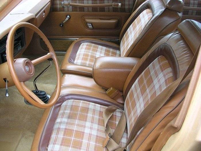

    I really like that plaid color and pattern for some weird reason. Maybe it's because it is so "70's". It really fits with the F's. The pattern on these buckets seems to be the same material that was used for the "Hillcrest" plaid seats in the wagons. I still haven't had a chance to put my plaid 60/40 seats in OY yet, but I have a question: Does anyone know when they changed the floor hump for the catalytic converter on the F wagons? This may be a problem when I do get around to swapping the seats, because I got the plaid 60/40's out of a '77 Volare wagon, and OY is a '78 wagon. If the change in floor pans happened between '77 and '78, I will have to make some modification to the inner passenger side seat track. Here is an internet pic of what OY should look like when I finally get them installed:
