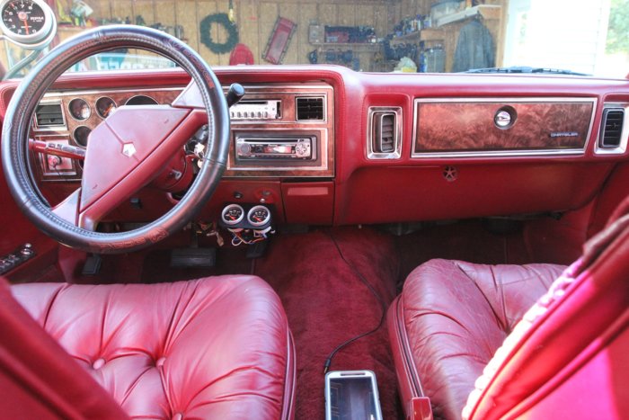

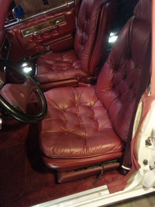

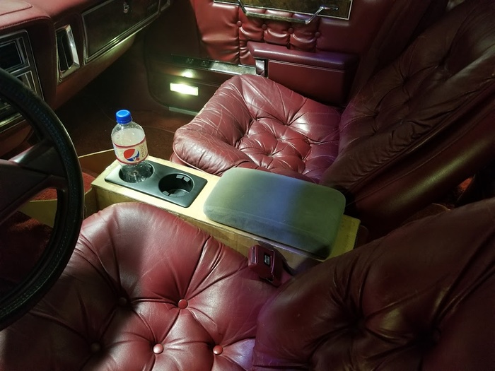

    Anyone ever make up a center console for their car? A few years back I got my hands on another passenger seat from a red leather 5th and adapted it to the driver's power track for buckets. I've tried mocking up a couple out of cardboard before I build, but I haven't liked any of them. Would be nice to have room to mount gauges in it - that's what the extension was meant to be to the left of the Pepsi bottle. Ideas?
    Thanks guys.

    I like the idea you have.
    I miss not having a cupholder, and the cheap things that fit on top of transmission tunnel are useless.

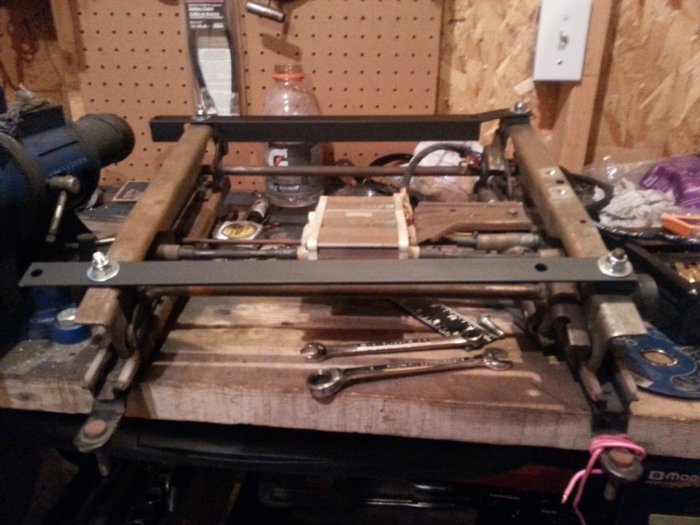

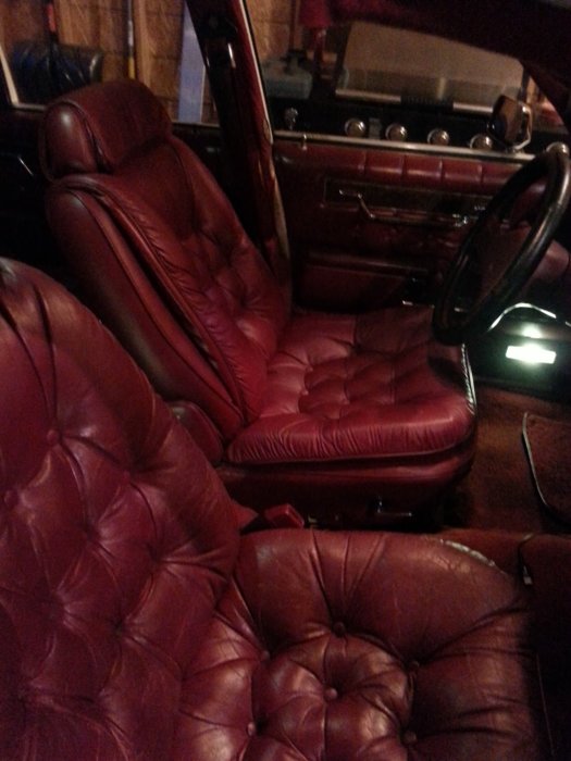

    You don't need to modify the driver's track. I used two pieces of angle iron to adapt mine. The seat will actually bolt to the driver's frame, but when you go to put it into the car it'll hit the B pillar, so I used the angle iron to shift it over a couple inches.
    Wasn't bad at all. I used a couple wrenches, a hand drill, center punch and a 6" angle grinder to fab the brackets. Worst part was pulling the seat in and out of the car multiple times for measurements. Damn thing is heavy!

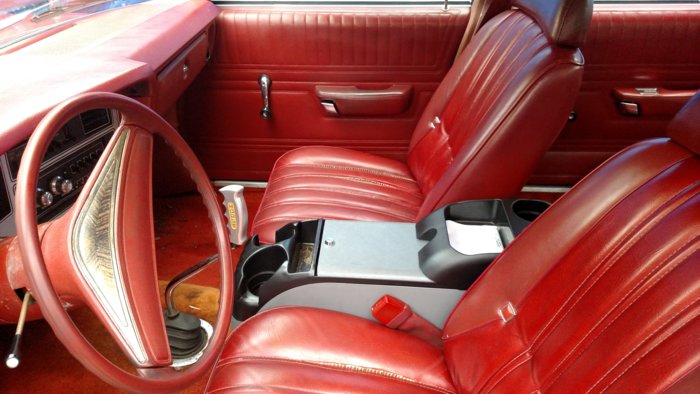

    I found one at Wallmart for $30 that I put in my Volare. It fits Snug enough that I haven't bolted it down, yet. It has 2 cup holders for the front & 2 for the back and a very flimsy lockable compartment, also a coin holder. I plan on dyeing it and doing other mods eventually.

    This is setting over the tabs for the original center cushion. It fits good, just planning on some dye & mods before I bolt it to those tabs. Big Gulps are a little tough when shifting.

    What is that console out of?

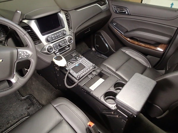

    I have also been considering installing a Havis police console. They obviously don't make one for the car but it's steel so it can be fabricated to fit. I got to know them while I worked as an installer building police vehicles for about 8 months. Would be a cool place to install a CB radio as well...

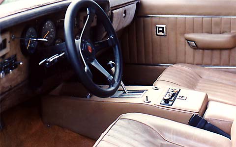

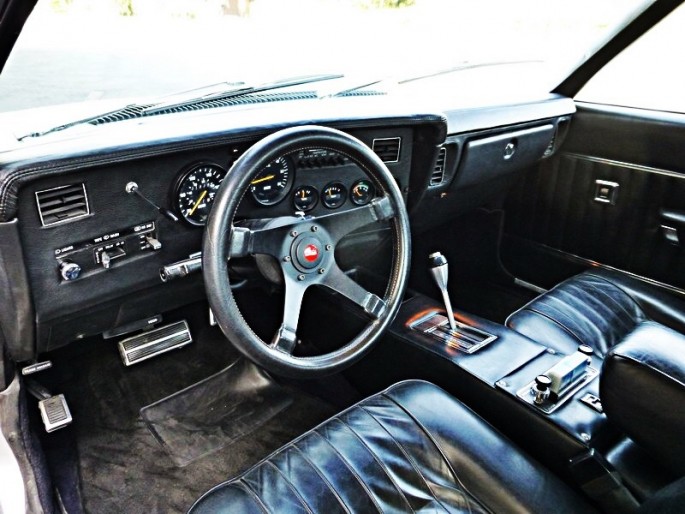

    Just get a 77-80 Monteverdi Sierra console.
    Drops in.
