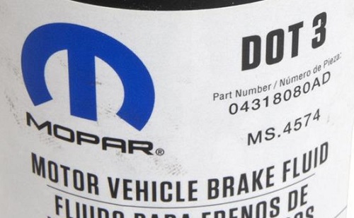

DOT 3 new - 400’ F (205’ C). with 3.7% water moisture absorbed – or referred to “wet” – 285’ F (140’ C).

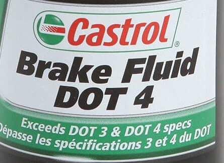

DOT 4 new – 445’ F (230’ C), wet – 310’ F (155’ C).

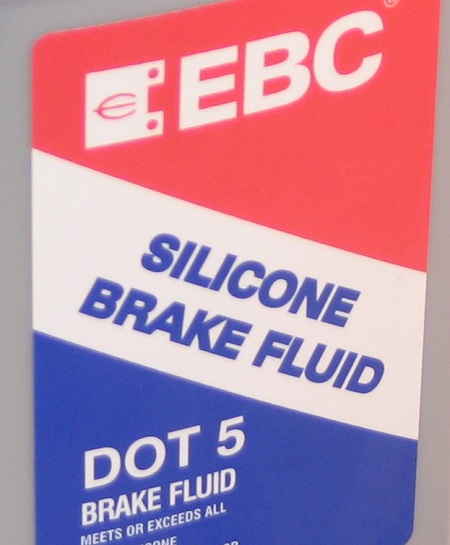

DOT 5 new – 500’ F (260’ C), wet – 355’ F (180’ C).

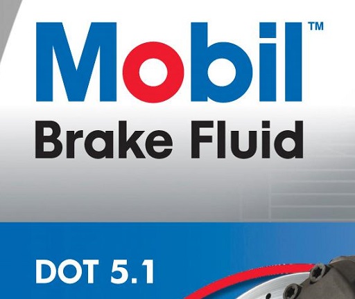

DOT 5.1 new – 500’ F (260’ C), wet – 355’ F (180’ C).

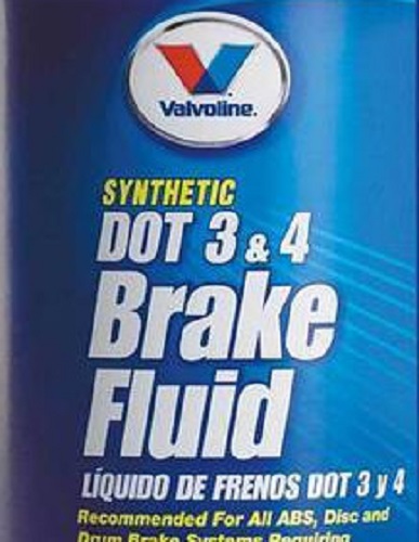

This is DOT 4 fluid - but marketed to those who don't know the difference between the two.
