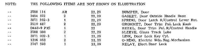

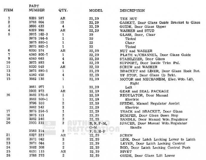

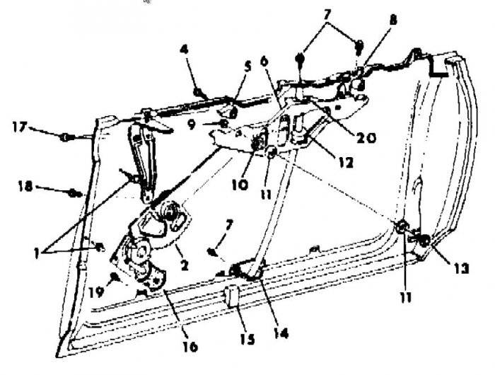

Attached are pictures from my '82 parts book, as well as my '79 parts book (F & M 2-door) but they are not really compatible. I don't have the '80 or '81 parts book to look at or any service manuals for J-bodies.

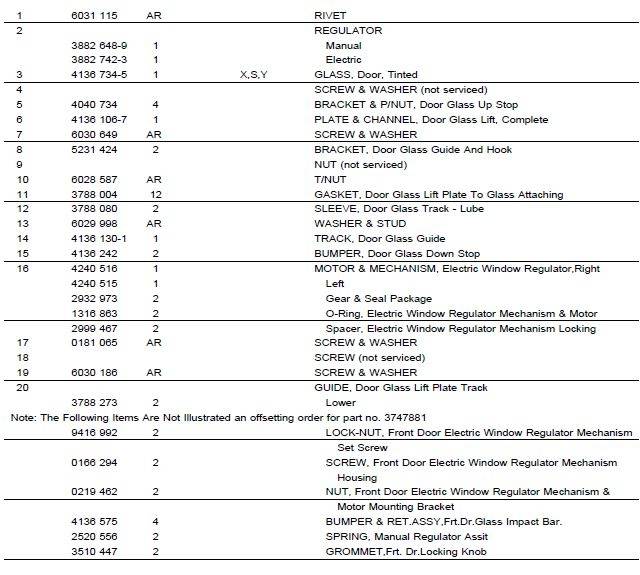

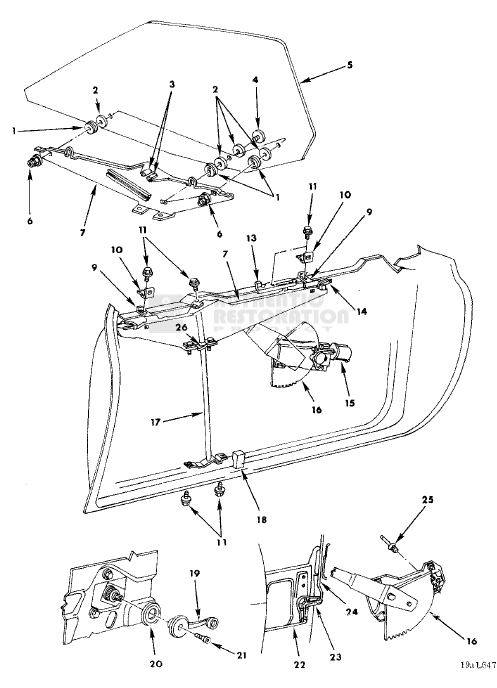

The last two pics are a blowup of the first picture.
