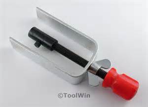

    You will need a steering wheel puller and a lock plate removal tool. It presses the lock plate down so you can remover the snap ring that holds it to the shaft. Then it's a matter of three(?) small screws which may be hex head or phillips and the one that holds the signal lever to the switch. Also need to remove the hazard flasher knob (small phillips screw) It's not a bad job to do.
    Lock plate tool:
    lock.jpe

    thank you will get lock plate tool

    started this job today and you don't need a lock tool just puller - phillips -1/4" nut driver hardest part is getting plug up through i cut old one off and pulled the new plug apart. if i did this again it would probably take about 45 minutes
