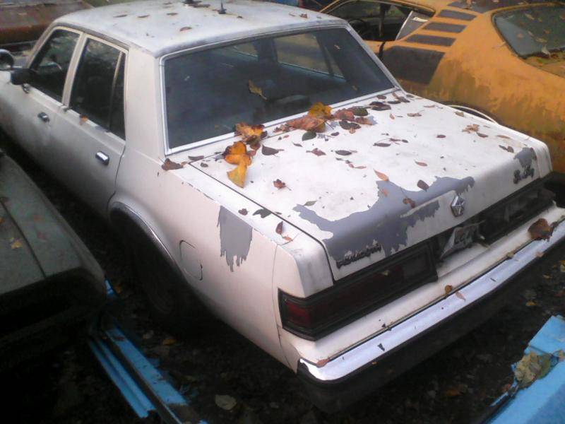

Look for the AHB code to determine if it's true, though usually the telltales will stand out: the hole in the a-pillar where it used to wear a spot light, the plain jane taxi cab interior with power windows.
And, yes, if you beat the bushes hard enough, they're still out there. I've got my eye on one right now, for a reasonable price.
