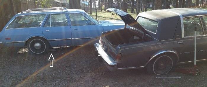

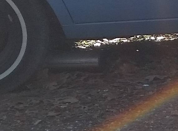

First, I hadn’t been able to drive my wagon (look at white arrow) for a couple of days. I ran over something in the road, with my kids in the car (about 30 miles from home, in middle of nowhere). I thought I had knocked a frame rail off of the car – it was that hard of a hit.
No abnormal noises, no leaks and car was still running OK, so I kept on going.
I will say that this car has always been loud, exhaust wise – mainly an exhaust drown noise.
About a mile from home (same trip), It started a clunking noise - then about ¼ mile from home, the muffler started to drag on the ground. It’s not yet in my budget to fix – but will be soon. A fairly new looking muffler, as well.
I go out next day and then see a flat tire – just after dropping the kids off at school – so in a short time frame I go from having 2 cars running – down to 0 cars running.
The tire has a small screw in it – which I can fix . . . but my flat fix tool kit grew legs and walked off.
Getting another flat fix kit is also out of my budget – so spare tire will have hold me off for a couple more days.
