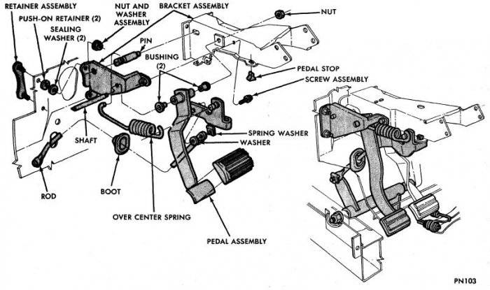

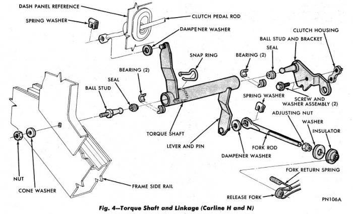

I've got what I hope is a simple question. What gauge steel do you use for frame repairs? I also need to know how the Clutch linkage hooks into the chassis. There is a bracket on the transmission but the other end was just through a hole located just above the frame in the inner fender panel.

Does this help?
I pulled the torque shaft right from a frame of a beat 79 back in 2011. Is the fork return spring what brings the pedal back to rest height? Or will the over center spring do that?
