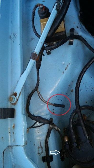

    Fender top turn signals were a popular deader add-on, back in the day.
    Most of all of the ‘70’s and early ‘80’s have pigtails, at these locations for them.
    I don’t know about ’86, though.
    These pictures were taken from my ’77 wagon, a few moments ago.
    The pigtails are in red circles. The hole in inner fender is marked by white arrow.
    The lamps shouldn’t matter which side or what year (for the most part).
    The location on fender varies as well (especially on dealer installed lamps) – so unless you have an example to go by, there will not be anyone out there to know if they are in correct location, or not.

    Thanks much BudW!! I am hoping to find those pigtails on OY when I can check it out this weekend. I have a nice set of fender mount turn lights to put on after I get the power steering installed (the pump mounting brackets are on the way!) The question now is does anyone have the measurements of where the factory mounting holes are on the fender tops?

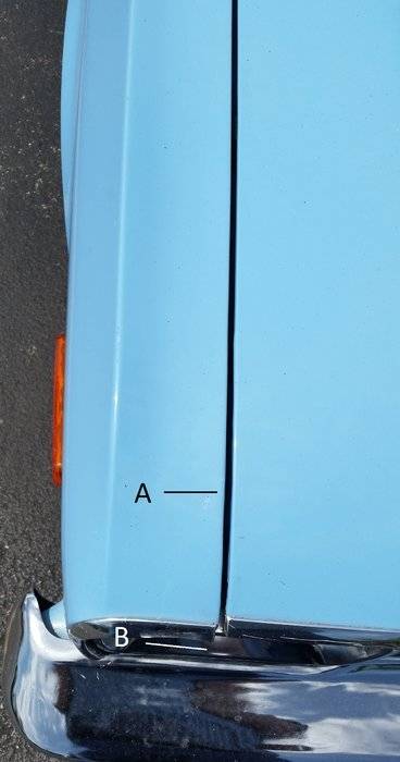

    Top of fender front edge (the 90 degree down turn of the fender is not flat so the measurement is from the most upper part of the bend) to the center of the hole is 7 3/4" and from the inside 90 degree turn down the center is 1 1/16". The hole size is 11/16". This info was provided by Mopars1 from A & V.Com.

    7T8 Custom - I read and re-read your above post a couple of times and I didn't quite understand your directions. Could you re-phrase that please?
    The front of fender is at a slight angle.
    I think you are referring to “A” as the start point of measurement going back (7-3/4”)?
    Or do you mean to start a front of fender at point “B”?
    If starting at point “B” then where at on the angle?
    7-3/4” from point “A” seams more reasonable but could also be a bit vague as to where the starting point will be at.
    I was trying to clarify for other members, here.

    Sorry Bud, but those are not my measurements nor my phrasing. All were cut and pasted from a previous post. From the way I understood the post, A would be the the starting point that would make the most sense to me.
