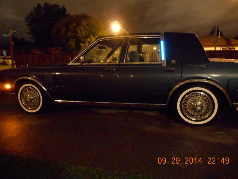

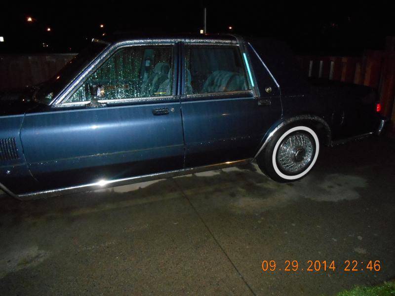

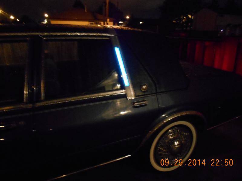

The original electroluminescent side marker lights embedded in the roof pillar chrome on the Fifth Avenue and other models left much to be desired. These lights normally only lasted a few years and then dimmed out to the point they are non existent.
I found and installed the perfect replacements from glowhut.com
They offer a full range of light products and the one to replace the side lights on the Fifth Avenue is " One Foot Electroluminescent Tape/Panel with 12v El Inverter"... $27ea
Ensure you buy the set which includes the new modernized EL inverter for years of trouble free and bright marker lights. I installed mine 3 years ago and still working fantastic !!
The replacement tape panels are available in several colors to personalize and for different effects .... the one listed as white is the closest to the original but it still has a blue hue. This is the one I went with and extremely pleased with the result.
