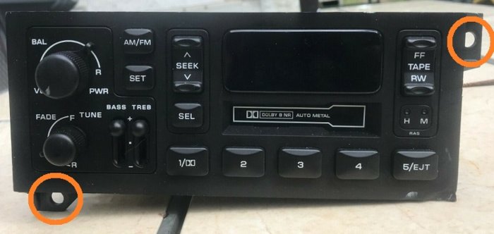

    Until recently, all Mopars use an 8 Ohm speaker.
    I have been told, over and over (and over and over), when I used to work for Chrysler (a long time ago), not to use 4 Ohm speakers, for it will kill the speaker drivers, in radio, each and every time.

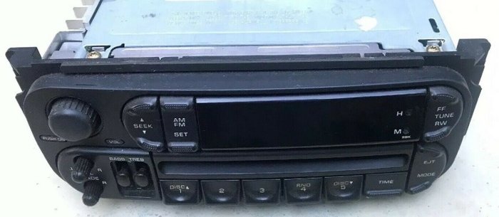

    The older radios did use 8 ohm speakers, but once Chrysler made the switch to the "high performance", "premium" radios, the ones that have the two modern wiring connectors on the back, these units are all 4 ohm units.
    The real trick with the new 3.5's for the dash is finding a set that does not have a tweeter that sticks up above the woofer. I found a set that were lower profile, but I put adhesive pads at all four corners of the speaker that were taller than the new elevated tweeters. This way the top dash cap did not contact the tweeters, and impede their movement.

    Chrysler changed over to 4 Ohm speakers when they got away from the rectangular unit they have used sense the early ‘70’s – so roughly 2000 or so (not sure of the changeover to the rounded corner radios).
    I think that is what you meant when you said
    If you meant something different, then we may have to agree to disagree.
