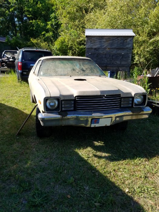

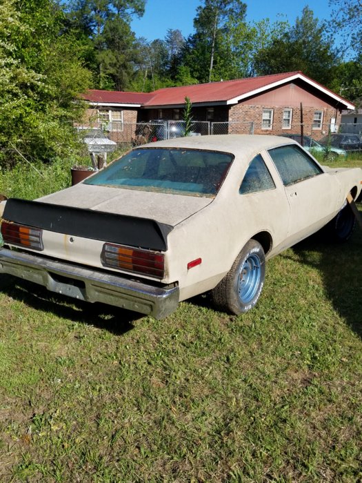

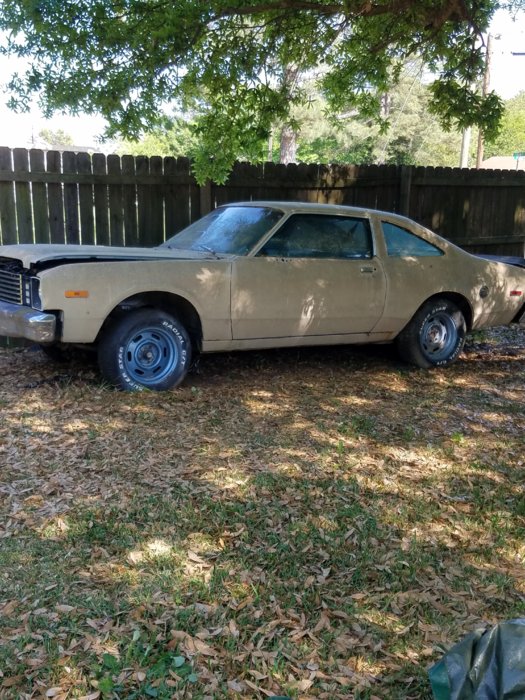

    She's a 78 or 79 Coupe has a good Grill Hood School trunk deck spoiler complete interior that is in almost perfect condition have all the clothes out for the bumpers and another set of bumpers also

    Nice looking body,, time to get her road ready,, enjoy
