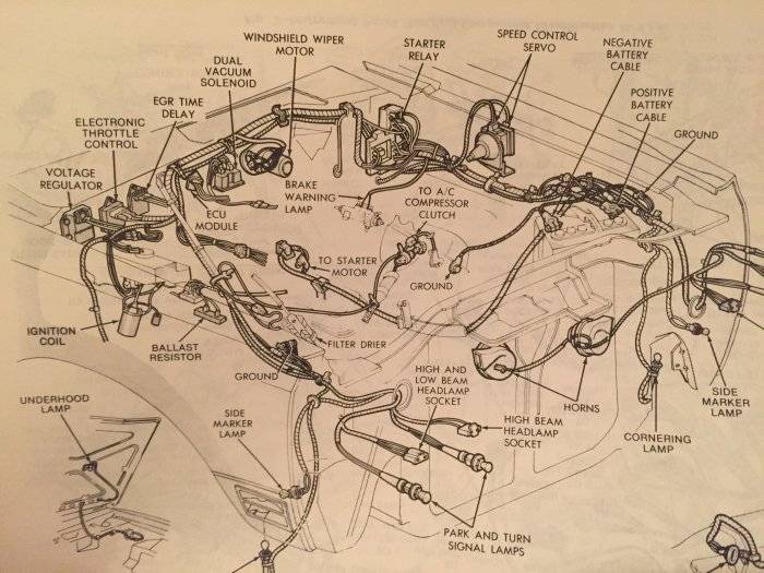

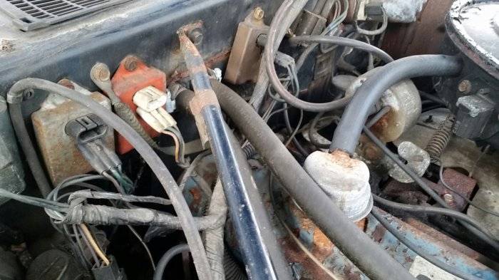

EGR timer (Orange)
The other two I believe to be for air pump diverter valve (switches from upstream to downstream air flow). The other could be 318 passenger side heat riser vacuum control – which I don’t think applies to /6.
It might also be an A/C cutoff module when throttle position reaches certain position or an anti-diesel module (keeps throttle open a bit after shutoff.
I don’t have any manuals for ’81 car to look at – to know for sure.
Just because the “goo” from backside of module melted out doesn’t mean the module is bad. I have seen brand new modules, still in box, with that goo melted out and stuck to box. As long as the PC (Printed Circuit) board is not touching the can or chassis, then you should be fine (except for the gooey mess).
I think the goo batches varied on humidity and contents available on hand. It might also had to do with the alcohol level of the “mixer”.
