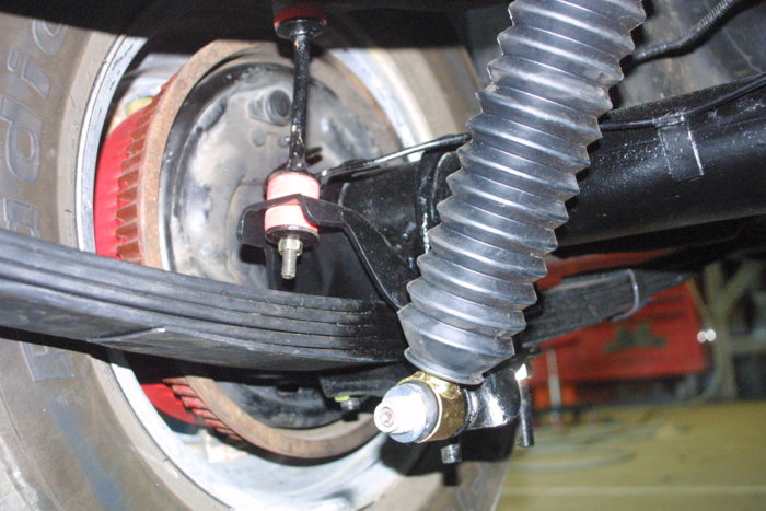

    Awesome service. I've got a ton of their parts in my car. They should be able to set you up with something like this:
    That plate the sway bar link attaches to came from them and allows the usage of a factory F/J/M sway bar.
