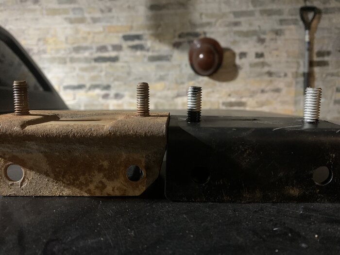

Not the greatest photo but you can see the difference in their hight and tab/flange length.

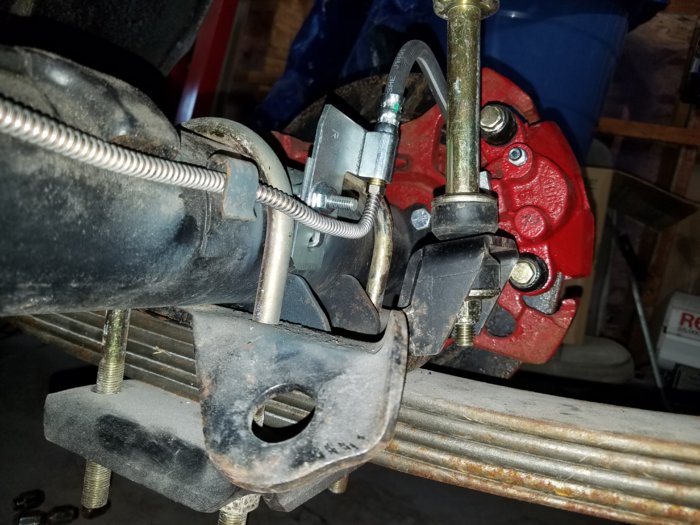

A rear bar may be just what my car needs. I looked at the FF bar and am curious. How do the links mount to the spring plates? The photo on the site doesn't make it obvious.
The spring plate mount has three “prongs” that come off the bottom of the mount and essentially grab onto the trailing side of the spring plate ( like three fingers ) and get welded into place, centered to the spring plate and perch.
the two outer prongs butt up perpendicular to the outer trailing side/edge of the spring plate. While the middle prong runs parallel to the trailing edge of the spring plate and gets welded to the topside of the spring plate, between the perch and trailing edge of the spring plate.

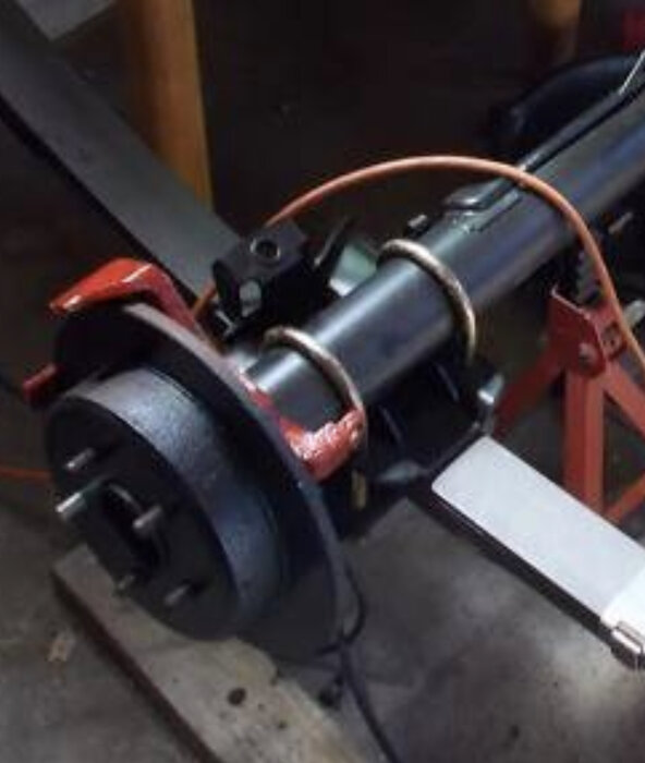

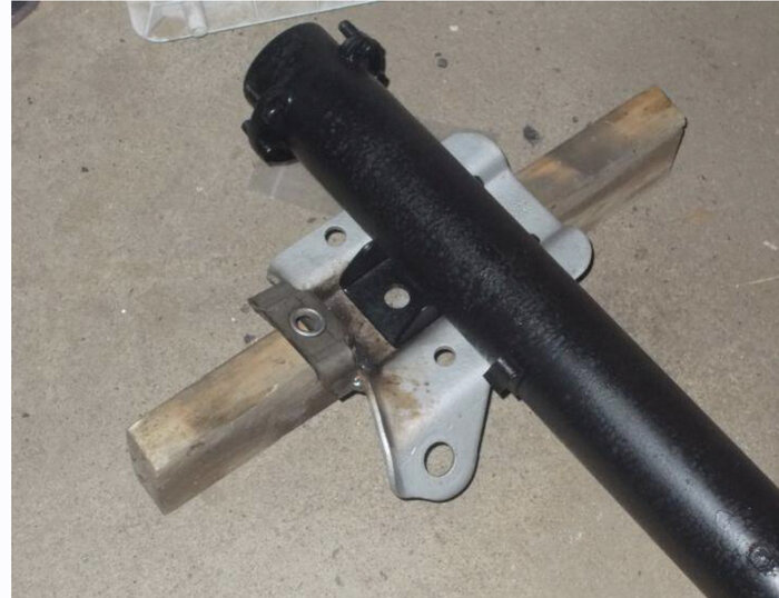

a few pics I pulled off, @80mirada build thread. It’s about 9 degrees outside, don’t much feel like going out to the garage and laying on cold concrete, lol.

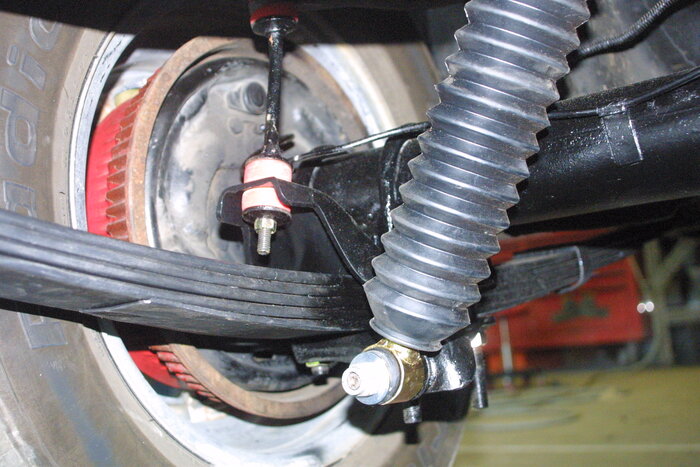

Old photo, but Firm Feel used to sell plates with the link end cast into it instead of those tabs you need to weld on. This was probably 13 years ago I took this photo, but I'm still using those plates. Don't see them on FF's site anymore.
The plates Duke has are E-body style plates and work for when you swap to the earlier style shock plates. Firm Feel still has them and they are an option in their rear sway bar kit, last I knew
