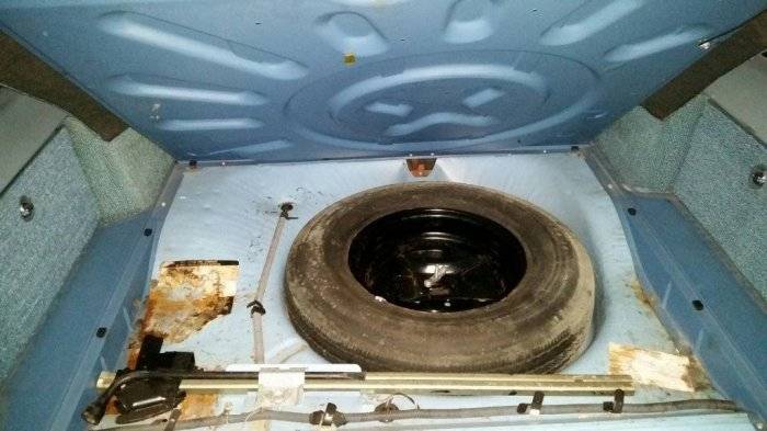

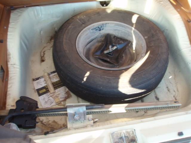

    All 4-door models (sedans and wagons) appear to share the same floorpan – from edge of firewall to trunk (* see below). 2-door F and M bodies also appear to share the same floorpan - which is shorter than 4-doors. I “suspect" a person can modify a 4-door pan to fit a 2-door without too much work.
    J-body floor pans “should” be the same as F and M body’s – but, honestly, I’ve not done a comparison to make sure. I do know that some J-body transmission crossmembers are (completely) different.
    (*) There are two different design trunk pans - those with round spare tire hole ’76 to early ’77) and all others (late ’77 to ’89). The piece that connects the floor pan to trunk pan “I believe” is the same for all FMJ-body’s.
    From my early '77 wagon.
    Late '77 to '89 version (also a wagon).

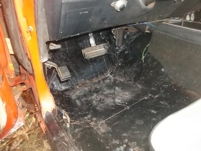

    This second pic is of the rear cargo tire well in Old Yellow, my '78 Aspen wagon.
    I'm not sure if it will help you, but below is a pic of the floor pan in OY just after I painted it recently. I was very fortunate in that it only had a bit of surface rust. It was a desert car from the Pueblo CO area.

  10. BudW
    BudW Moderator Staff Member
    3,658
    977
    Yes it is!
    If I find a good a good picture, I save it.
