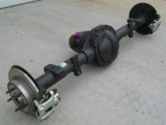

I’ve been looking (pretty hard) at the specs of the 95-01 Ford Explorer rear ends. Width is about right (59.50”). Comes with a good selection of gears, limited slip, disk brakes and the bolt pattern matches the Mopar. Anyone have any experience with the Ford 8.8? I’ve got an 8.75” out of an early “B” body in my big block Volare now. Might be worth upgunning to something like the Ford.
