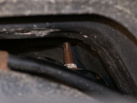

    Is it easy to do to replace the front shock absorbers? I have not recently been busy with the suspension, but should be loosened the torsion springs? If I look like this, the damper is locked between the hanging plates.
    Thanks in advance!

    You should be able to remove and replace shocks without doing anything else.

    In theory it's very straight forward. In reality they old ones are so rusty and frozen in place that it's not worth it to do yourself. If you decide to do it yourself, remember that the new one has a strap on it (DON'T CUT THE STRAP UNTIL IT'S INSTALLED)
    Trying to compress that shock by hand to install it is damn near impossible.
