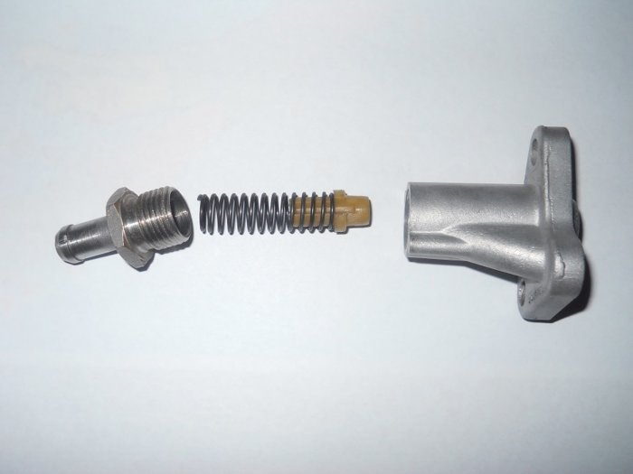

Yes, there should be a sealing washer. Unsure of the material but I would GUESS copper but some sealing washers are steel or aluminum. In the service manual the exploded view shows a washer. The parts catalog doesn't show one but says the hose nipple is "serviced in pkg 40457085" which is the valve and o-ring pkg.
