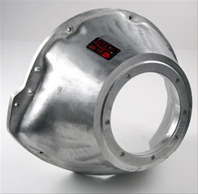

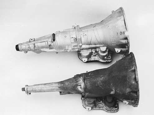

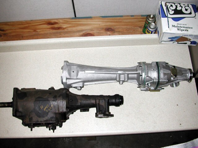

    A few random pictures:
    Big block to A518 (or A727) bell housing
    A518 (top) vs. A727 (bottom).
    Note: the A904/A998/A999 is about 4" shorter than an A727 is.
    An older ('68 or '69?) B-body A727 with Gear Venders attached.
    An A833 (4-speed manual) showing tail housing length difference (for comparison).

    The A518 doesn't look that at much bigger than the 727 aside from the tailshaft being bigger. Is that where floor modifications need to happen, further back the trans tunnel for the tailshaft?
  15. Duke5A
    Duke5A Well-Known Member
    662
    234
    Yes, tailshaft forward it's the same transmission. Where it interferes is the where the crossmember follows the contour of the tunnel.
