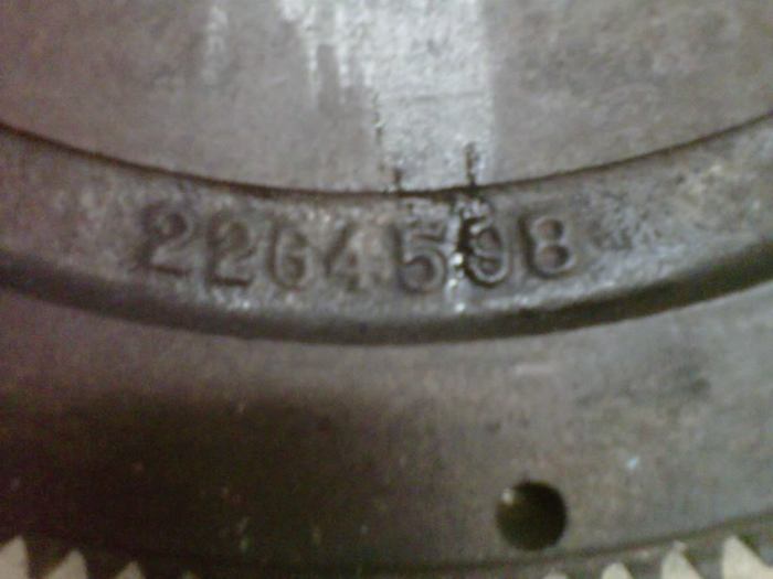

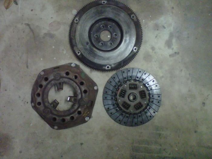

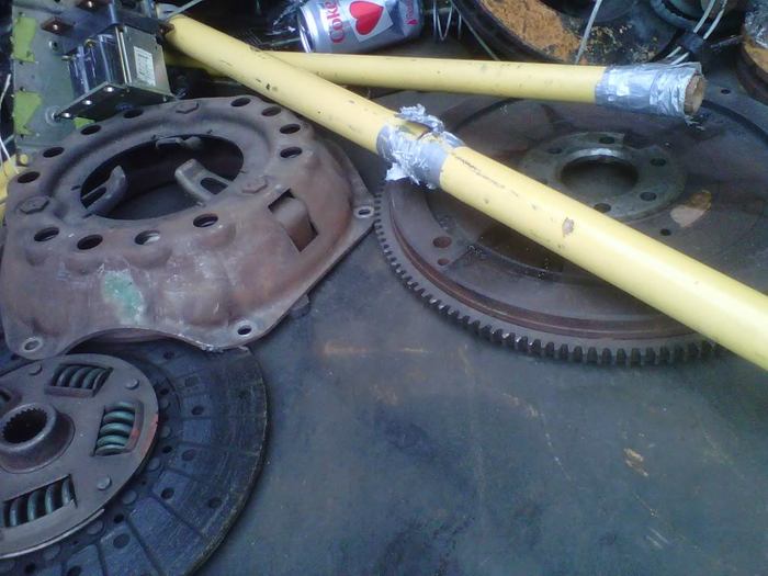

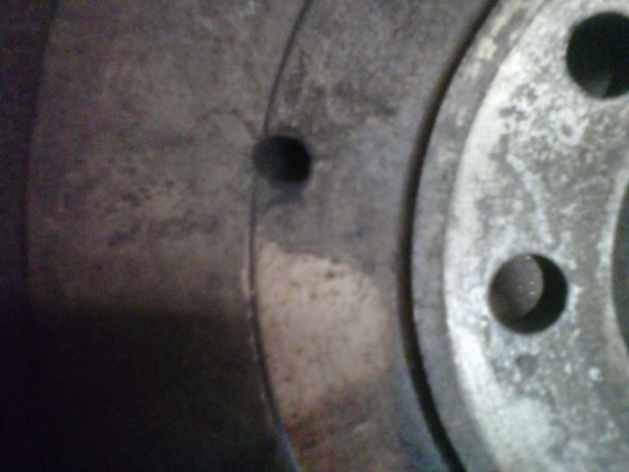

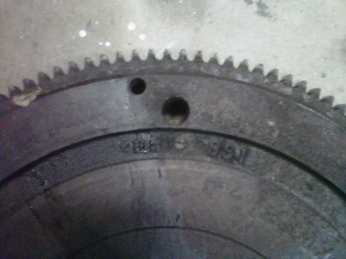

Heres some info for thought along with this item for sale...external or internally balanced..heres some pics first..
then I did a search on the casting number 2264598 and came up with all kinds of conclusions..
heres some more info...

Dan, all factory 360s are external balance. I can't explain the vagaries of the aftermarket - ask them why they are so screwed up!
But why not just drill the 360 balance holes in the 318 flywheel? This is what the factory did! This trick works fine on any and all ferrous-metal flywheels (i.e., steel or iron), and the specifications on the drawing are correct for all '71-92 360s.
The bad news? Expect to pay fairly big bucks for the drill bit. However, you could also do the math and remove the required mass - 19.79 in.-oz. - by using a pattern of smaller diameter holes.
So, you're welcome, although, as you can see, maybe not a ton.
Rick
Balance drilling specs for all '71-'92 360s with ferrous metal flywheel.
