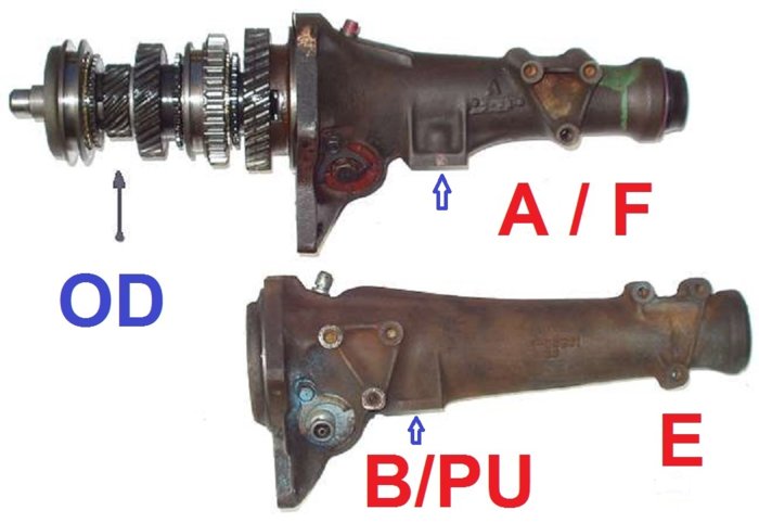

A, F, M and J-bodies only got the short tail housing version (top). The two will interchange just fine – but shifters are in wrong location. IF you are not going to use a console and can modify the shifter handle, then I see no reason why the (non-E-body) long housing A833 will not work.
The distance from front of the tailhousing to the transmission mount are the same (to blue arrows).
The overdrive gear ratios should work good for your desired engine choice.
I haven’t had enough Z-bars in one place to know what interchanges with what. Logic says only an FMJ body Z-bar will (only) fit – but there is also a good chance others will, as well.
If you have the “casting numbers” on your existing bell housings – can tell you if they will fit, or not.
The big thing about bell housings will be the transmission input bearing retainer diameter. It will need to be the same diameter as the bell housing.
To check if yours will fit, put the transmission on a pair of 4x4's. That should get it off of the ground enough for you to dry fit the bell onto the front of transmission. The bearing retainer should fit snug into the bell housing and it should have the funny transmission bolt pattern on it.
If it doesn't fit snug in the hole, then measure the two holes and report back.
IF you have a long housing transmission - then it is fairly easy to change it over. A short tail housing and short output shaft, as well as some labor and gaskets.
