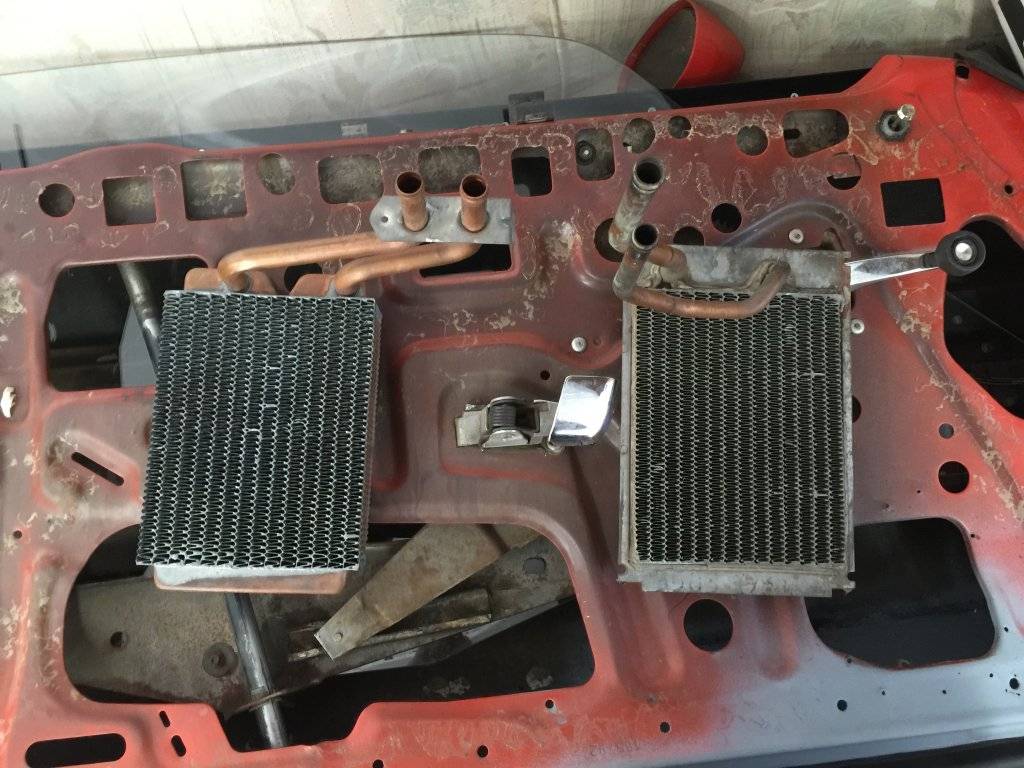

New heater core came today. It doesn't look exactly like the factory one . But I'm wondering if this one will and if it's installed, will the rest of the dash fit around it?
dude, I hate to say it don't look right, but it looks like the tubes are way off. My car was an Ac car and the heater box is different than non AC. What is your car? AC or Non AC? Reference my video for some help: Go to the end since you have the removal down.
