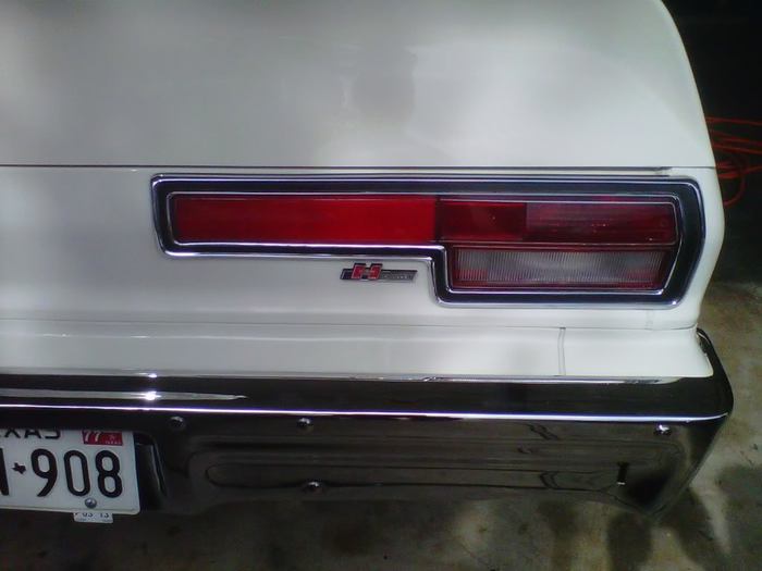

Well after rubbing the back section and getting it clean...I decided to give it a try. Lots, of black..red and chrome.

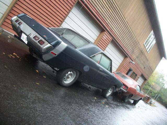

I have had one on my swinger for a few years now. Right rear of the deck lid.
And yes it is Hurst equipped

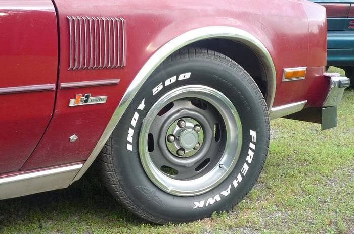

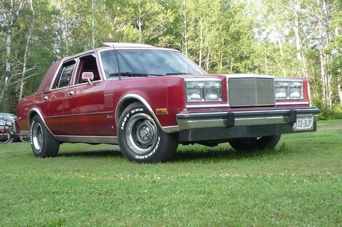

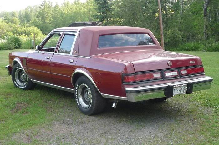

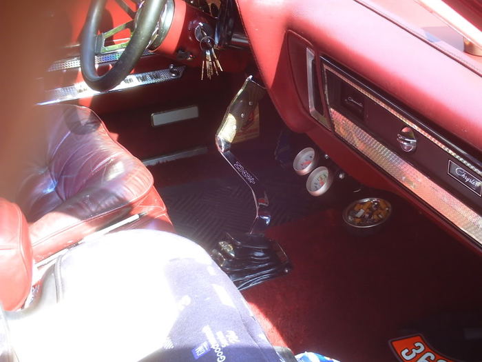

my father has one on the trunk lid of his 5th ave in place of the fifth avenue emblem, and one on each front fender, and yes its a 4 speed

I love it !!!!!!!! I want to put a four speed in my 5th. Can you give me any details like what tunnel did he use, peddles ect. Are those super coupe wheels.

pedals,trans tunnel, and the bracket on the frame are all from an F-body. pedals bolt right in and the trans tunnel requied cutting the original out and welding in the f-body tunnel and the bracket for the linkage requires welding it to the frame. and yup they're supercoupe/cop wheels

They are not Super Coupe wheels.... cop car wheels = 15x7 and have hub cap bumps, SC wheels = no bumps and 15x8
Sorry to sound like an ass but thats one of my pet peeves.

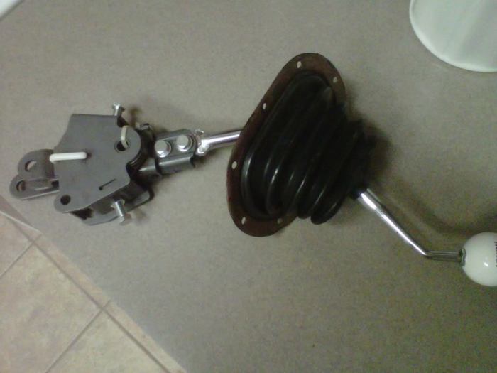

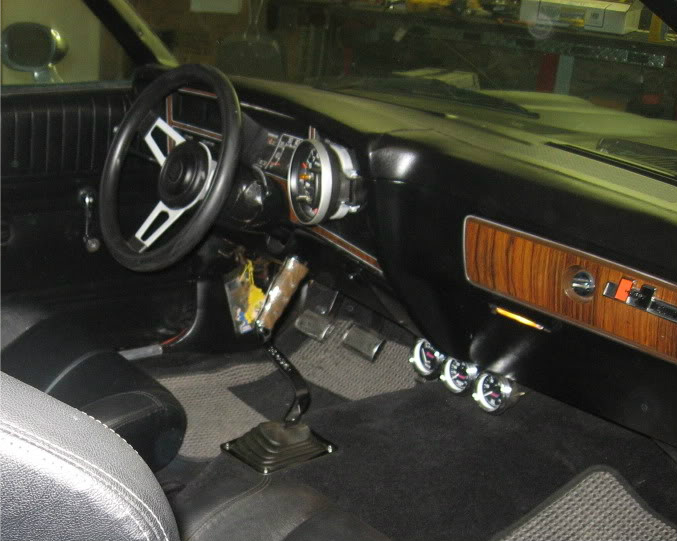

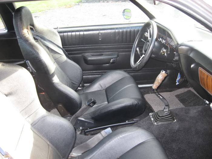

Wow love the Hurst Pistol grip look with no console.
Wicked seats, Volarerob, what are they from?
