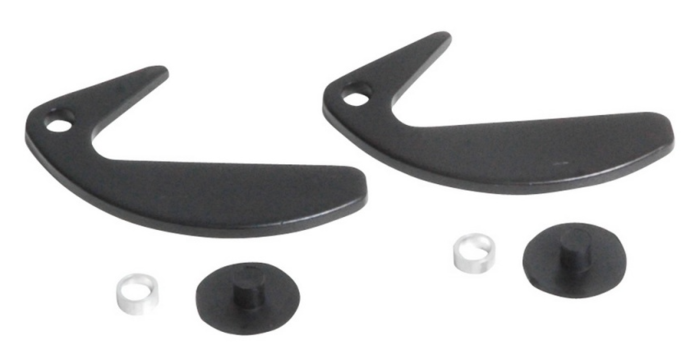

I don’t know much about MSD distributors, but I know the (newer) factory appearing Chinese made distributors that fit our car has flimsy lightweight counterweights that will do just what you are describing. Even the later model Mopar Performance distributors use the small weights and are also “troublesome”.

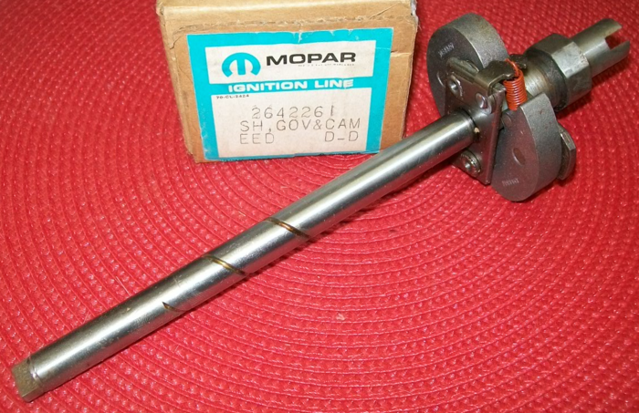

The thick and heavy Chrysler style weights.
The thin and troublesome weights used today.

If you have the “skinny/wimpy weight style distributor (aka: Chinese built) – then the only recommendation I have is to find an original Chrysler distributor and install and that most likely will fix your problem (but your MSD might be a factor). As to which distributor (advance curve) to get depends on your current application. If you have a highly modified small block, I would look for a 340 or 360 HP version. The rest of us, I would look for a 318 (2-bbl) version. Either version need to have a vacuum advance on it. If not, stay away (for Lean Burn or computer-controlled versions, which also has no mechanical weights inside).
If you purchase an older distributor, but before you put it in use, I recommend taking the top half apart (see top picture), cleaning well, add grease to areas the weights contact (pivot points, etc.) and a drop of engine oil where the two shafts touch (under the small felt under the rotor), test the vacuum advance (for leaks), install and set ignition timing, and call it a day (if test drive is good).
