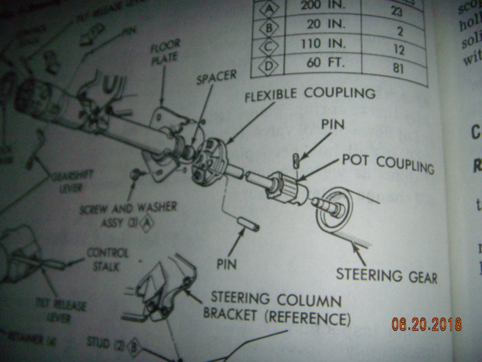

    What kind of shape is the wrag joint in ? If that goes, well, you know.

  10. Poly
    Poly Well-Known Member
    73
    18
    Jun 15, 2018
    USA
    Hi.
    A wrag joint is the break or joint between the steering column and the steering gear. Usually a disc from each piece with a rubber cushion in between, maybe a half inch thick, much like tire rubber. Guess it's an ingenious invention as it allows movement or shock absorbtion between the cabin mounted steering column and the k member mounted steering gear.
  11. Poly
